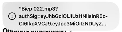

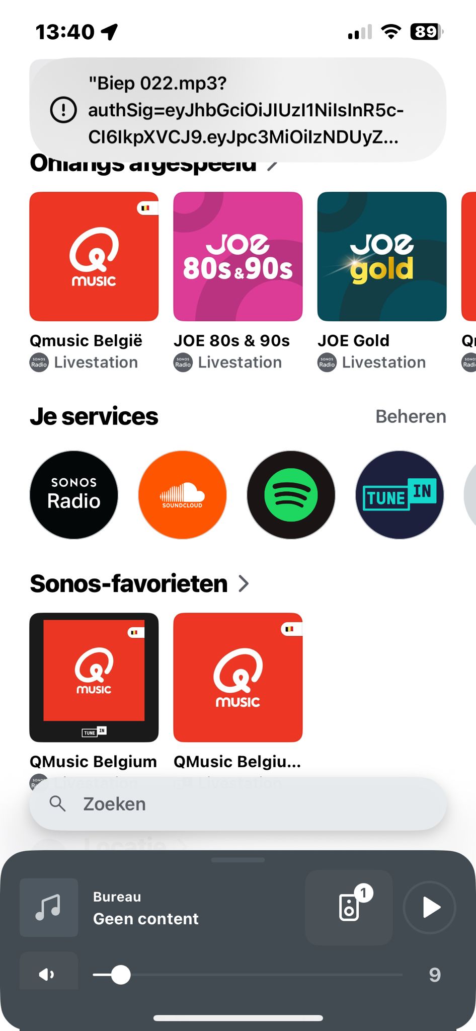

Yes, MP3 doesn’t work either. The music stops playing, but the MP3 doesn’t play.
entity_id: media_player.bureau_sonos
media:
media_content_id: /local/Geluiden/Biepen/Biep 007.mp3
media_content_type: music
metadata: {}
enabled: true
action: media_player.play_media
If I try this I do get a message in the Sonos app.
This automation has always worked and now suddenly it doesn’t anymore. And I haven’t changed anything.

So it’s a general inability to play anything and not just TTS messages.
Looks like it’s an issue at the Sonos end.

Mabaelst:
how to solve it?
Enable debug logging for the Sonos integration.
Play the “Biep” file.
Report the problem as a new Issue in Home Assistant’s Github Core repository and include the debug log. Include the screenshot of the Sonos app you posted above.
