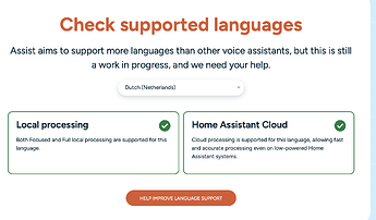

Figured it might be the language, and I should really start experimenting in English (which would have been fair) but according to this it should be ok in Dutch

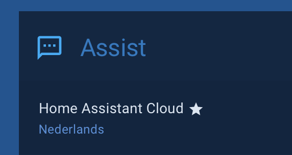

Have you configured the voice pipeline so that it will use Dutch?
I am using Dutch too and i have only minor problems. Most of them are spelling issues.
Voice assistant troubleshooting
i have not set any other settings no, I figured lets try. it out of the box, with all of my locale settings automated.
Will check the options you both mention and report back, thanks.
But given the screen above, at lest the Language setting is picked up, and of course the Assist responds in Dutch, so that part should be good to go

Yes all of those are in Dutch.
