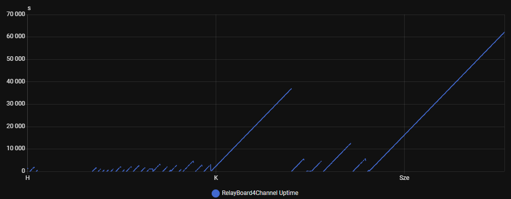

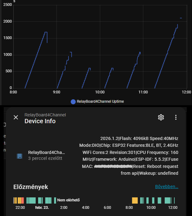

The main stability issue is that the device disconnects from my WiFi every few minutes or sometimes a few hours - and due to the API disconnection, it reboots itself. After rebooting, it is able to reconnect to my WiFi again. The access point is in the same room as the device. The reported wifi signal sthrength is around -50dBm.
My first thought was that the problem migbt be insufufficient power: my PC might not be able to provice enought current to the device throught the USB-C cable. Because of this, I powered it using a smartphone charger together with a PD trigger board (12V) connected ti its DC input. At the same time I kept the device connected to my PC so I could read the log via the serial connection.
Some more info:
  • ESP module on the relay panel: DOIT ESP32-32E N4
  • Sometimes I cannot update it’s firmware via OTA, but I believe this is related to the issue described above.
  • I wrote a test Home Assistant script in which I rapidly switch a relay on and off. In some positions (possibly blocking the antenna), the switching commands are missed, and then a large number of buffered switch commands are executed very rapidly afterward.
At this point, I’m trying to determine whether the issue is caused by hardware instability, power supply problems, or a software/ESPHome configuration issue. Any suggestions on what else I sould check or how I could further debug this problem would be greatly appreciated.

In my Home Assistant the uptime chart looks like this, and the device info is here:
Ok, I had an issue a bit like this - my CPU was too busy on the ESP device.
Why arduino and not esp-idf? Try with esp-idf?
Test without web server?
I would actual test without any component and just WiFi config and logging.
Also what does the contents of this sensor say?
text_sensor:
  - platform: debug
    device:
    reset_reason:
This is a classic case of the device being too busy and blocking the WiFi loop.
Remove these
  enable_btm: True
  enable_rrm: True
Add
fast_connect: true
Are all your varied power supply ground connectors connected? No switching power supply noise issues?
Do you have a static IP Address allocated to your device from the router?
I tried several changes, but by themselves they didn’t solve the issue:
  • Replaced the framework type with esp-idf
  • Removed WebUI and Captive Portal
  • Removed Modbus UART
  • Removed WiFi btm and rrm
  • Added fast_connect
  • Added electrolytic capacitors to VIN, 5V, 3V3
Despite these changes, the problem was still present.
However, the following modification worked for me. After changing the WiFi configuration, the device became stable and has now been running for about 16 hours without any issues:
wifi:
  ssid: !secret wifi_ssid
  power_save_mode: NONE
  output_power: 8.5
It seems that, in my case, the WiFi output power settings were the key to achieving stability.

Sorry, I forgot to mention that based on your recommendation I removed BTM and RRM (edited). However, it was not stable without output_power settings. :frowning:
With fast connect and without output power limit it was not stable. :frowning:
