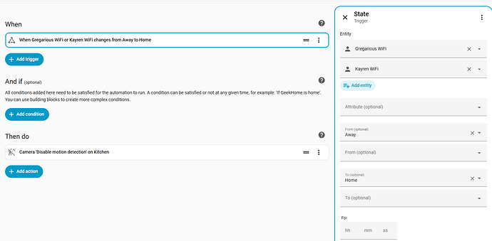

New Home Assistant user here. I’ve got my ubiquiti unifi networking communicating with my HAOS config. Setup my wife and I as ‘persons’ in HA and our presence is determined by our wifi phone wifi connections to the router. This all seems to be working correctly. I see Home and Away status for each person in the HA overview and entity details for each person.
BUT I cannot get an automation to trigger properly using these persons. See screenshot below. I’m attempting to activate or deactivate a kitchen camera motion-detect based on our status of home or away. See the automation (UI-based) below. What am I doing wrong? This automation NEVER triggers despite the fact I can see the home and away status changing…
I’ve tried home, Home, away, Away, not_home… Nothing results in trigger that is visible in the traces.
Have you tried removing the “from” field?

thanks @jackjourneyman removing the from field and editing the to field manually (in YAML) to ‘home’ fixed it.

You didn’t actually need to use yaml - you could just have removed “Away” from the from field in the UI.
