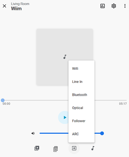

You need to be more specific with ‘cannot control’ e.g. the linkplay can via the gui

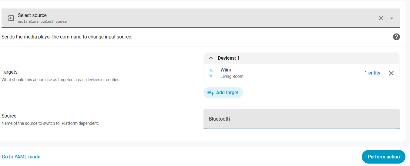

and there is an action
