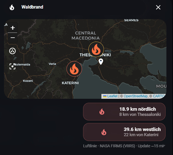

Dashboard tile:
pop-up:

Fun coincidence: my own dashboard has been showing a “fire” 19 km north of the house for days now — same coordinates every time, right in Thessaloniki’s industrial belt. Exact same thing. :grinning_face_with_smiling_eyes:
