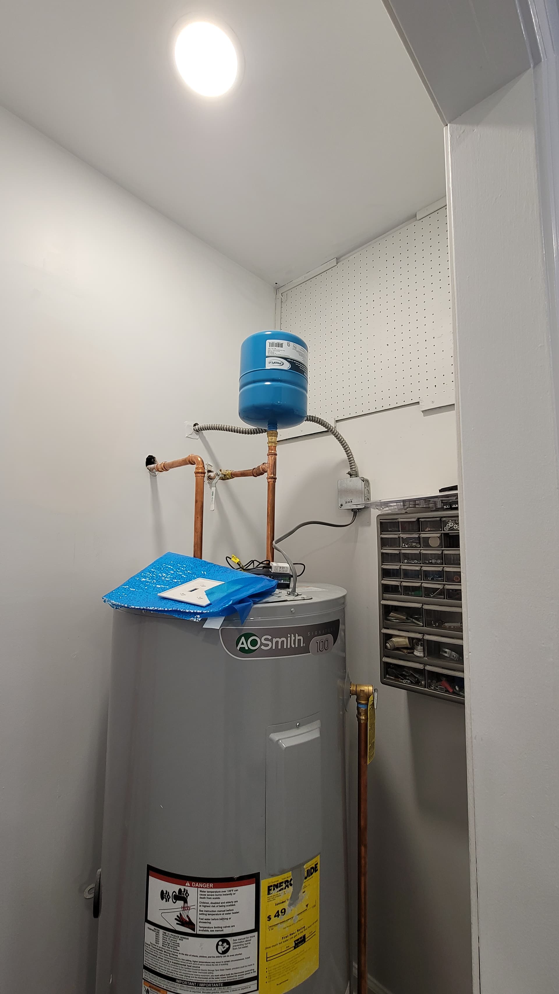

Will this space work for equipment and antennas?
Hey everyone I’m trying to figure out a good place to install my equipment. I used to have a great location right in the middle of the house but we’ve remodeled and it’s gone. So this is probably the next most realistic central location. But with the water heater and beadboard where I hang metal tools, there is a lot of metal in the room. I would have my HA Green, Google WiFi, Z Wave and sonoff zigbee antennas and a Bluetooth dongle.
It’s definitely not the only option, but it’s the path of least resistance right now. Just don’t want to do it and then realize I’ve selected a bad spot where the signals are blocked.
Just don’t stick your antennas next to the metal frames. Even cruise ships have reliable wifi network…
I’d be more concerned about the heat from the hot water cylinder.

I had a pinhole leak in copper pipe of water heater
Sprayed water onto wall above water heater
If you place equipment in same room with exposed water pipes be prepared for water spray
Plenty of space there I believe
Thank you! The hot water heater itself is well insulated, so does not emit much heat, but it’s definitely something I need to think about. I can monitor the temperature for a while as I get ready for the permanent installation. The area itself can be ventilated easily should it need it.

@tmjpugh brought up a good point about the water pipes themselves spraying during the event of a leak, which is definitely something I would need to consider, and @Spiro mentioned the heat from the water heater but as I replied there, I don’t think that’s an issue but will monitor temperatures for the next few weeks as I continue working.

Your walls in the sealed room might be opaque to radio waves, depending on their composition. Your hot water system will definitely act as a barrier for line of sight, so consider putting everything on a shelf above it our of harms way, keeping in mind that hot air rises so might be trapped in an unventilated room. If your body is not comfortable with temperature and humidity, your equipment won’t be either.
Any pipes in the room can also act as radio signal modifiers. Their effect may be far smaller than the big metal mass of the hot water boiler.
