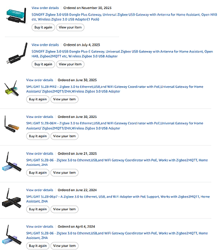

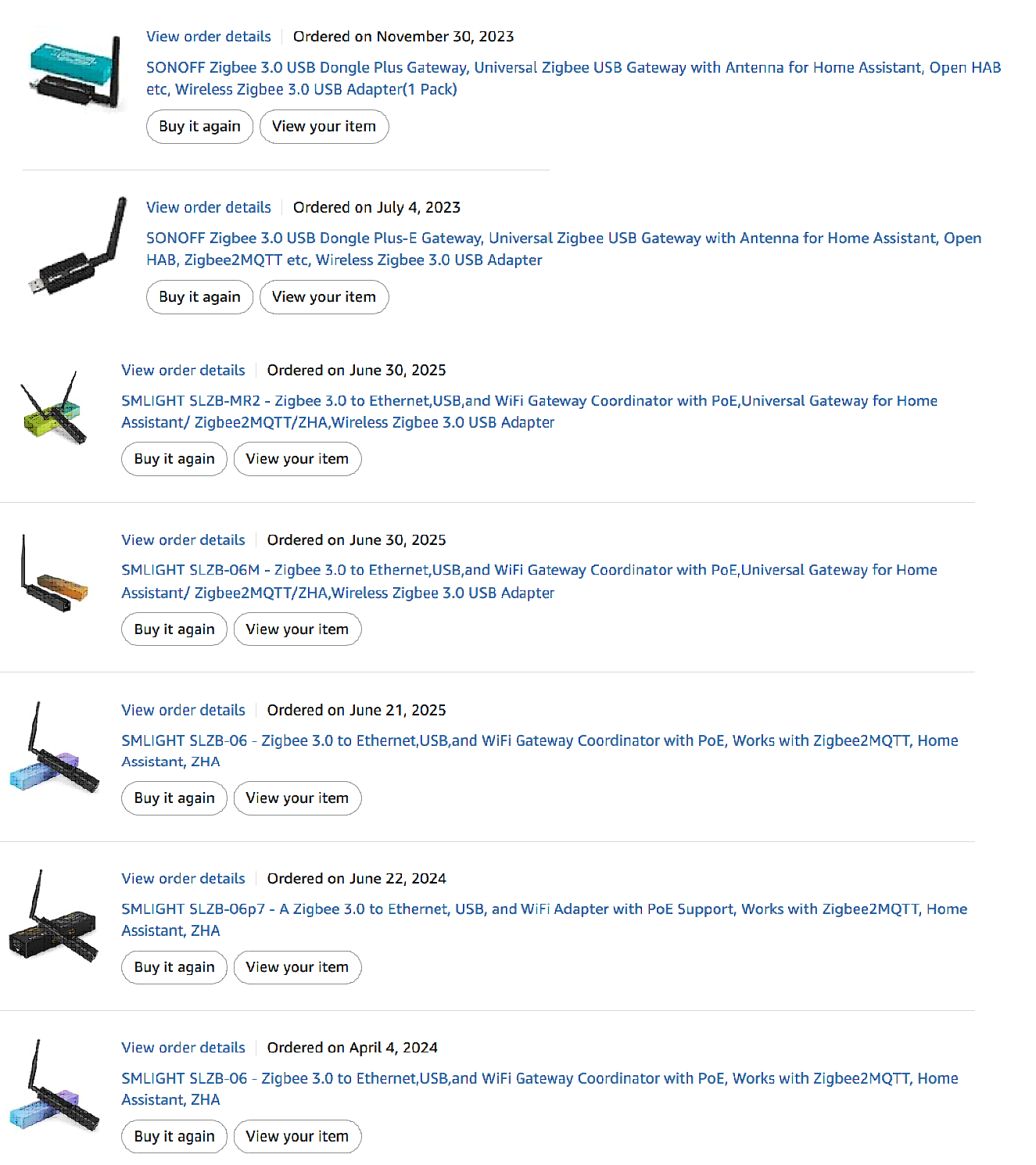

Currently running a MR2 and two SLZB-06s in router mode. I have an 06M and 06p7, but they were purchased for testing when those models were first on the market. I tend to stick to the TI chips.

I’ve own a few and this isn’t the complete list :rofl:
what is the difference between the bottom 2
