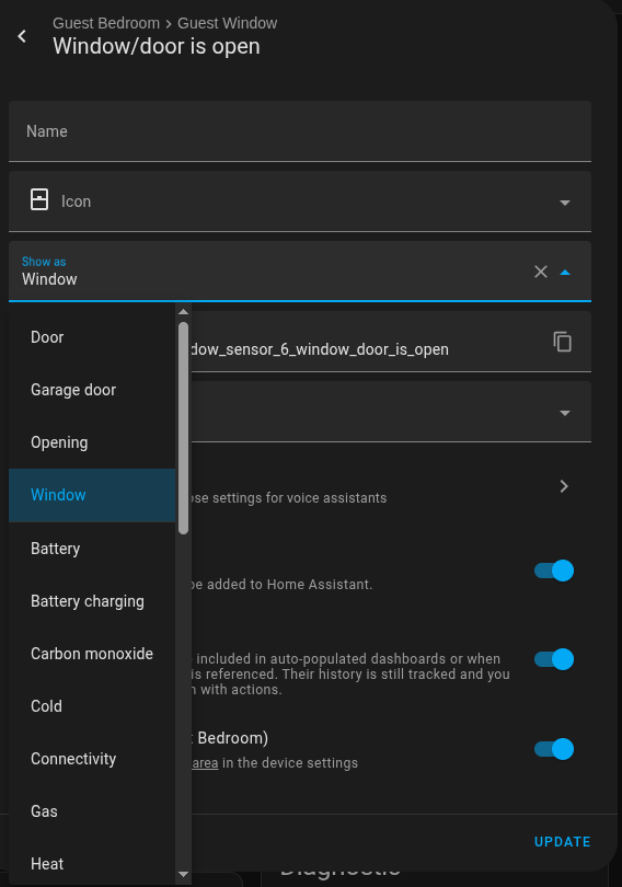

OK. Thanks. I at least got it to work the old way, by just clicking on the “x” beneath the icon field in the very same dialog were I changed it. So I’ll live with the US-window icons, which nobody in Europe understands, as we open our windows like doors.
I made a similar judgement call. I did notice that if I change how my contact sensor to “Show as” Window it changed the icon and retained the open/close designation.
