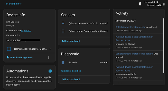

I have several Homematic HM-Sec-RHS in my home. Lately I’ve been using the auto-generated area dashboards and today I discovered, that these sensors won’t show up as windows.
Looking up the sensors attributes solved a possible “why”:
options: closed, tilted, open
interface_id: OpenCCU-BidCos-RF
address: JEQ026****:1
model: HM-Sec-RHS
parameter: STATE
function: null
value_state: valid
device_class: enum
icon: mdi:door
friendly_name: Kitchen Door
Every other sensor-type has “window” set as device class:
address: MEQ018****:1
model: HM-Sec-SCo
parameter: STATE
function: null
value_state: valid
device_class: window
friendly_name: Bathroom Window

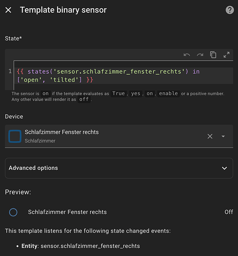

I did find a way:
If you create a template binary sensor and define it as window from the UI, you have the option to assign it to a device. Configuration looks like this:
YAML is:
{{ states('sensor.schlafzimmer_fenster_rechts') in ['open', 'tilted'] }}
where obviously sensor… is your own sensor.
