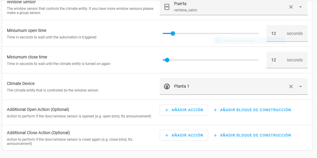

Good morning,
I’m using your blueprint; when I have AC on and open a window, it stops, but when I close the window, it doesn’t reactivate. My blueprint configuration is as follows:
Could you tell me if I need to do any extra configuration?
Best regards,
Hello again,
I’ve managed to get the blueprint working, but the problem I’m having is that my air conditioning is ducted. I’ve tried creating a group sensor with all the window sensors I have. When I test the blueprint, if I use the group sensor I created, the automation doesn’t work, but if I use just one device, it does. Do you know if there’s a way to fix this?
Thanks!!

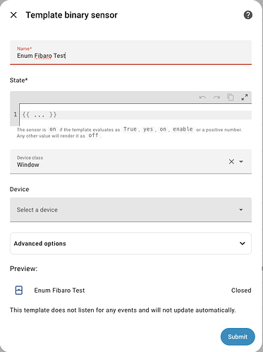

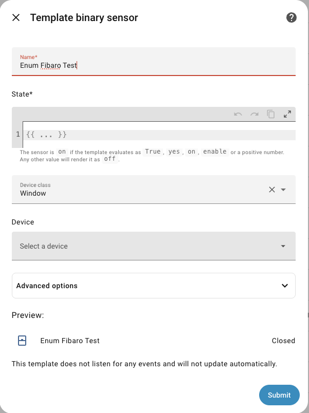

I have just find this very interesting blueprint and would love to test it.
My HA setup uses some Fibaro FGT001 TRVs over Z-Wave and I don’t have physical window switches, but I was planning to use the sensor that each TRV exposes through the Z-Wave integration.
Unfortunately these sensors are not device class window, but device class enum and therefore can’t be selected in this blueprint configuration:
options:
  - "False"
  - "True"
value: 0
device_class: enum
I was just wondering wether this blueprint can be adapted to support my valves?
Thanks for this nice piece of code!
You can try to use a Helper and make a “Template binary sensor” with the device class= window out of your enum sensor.
The Helper sensor is then recognized by the Blueprint and can be used

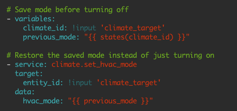

Modified my blueprint to restore the thermostat’s mode
OK, you code is less lines. But restoring the previous model is what this blueprint does as well! Wondering what HVAC state you missed.
