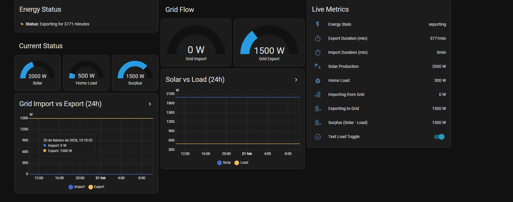

I’ve been working on a custom integration for Home Assistant focused on automatic solar optimization.
The idea is simple:
Detect sustained solar surplus and automatically activate loads to maximize self-consumption — without writing complex YAML automations.
:zap: What it does
  • Calculates solar / load / grid balance every 10 seconds
  • Detects sustained export and import conditions
  • Sends persistent alerts
  • Automatically controls up to 3 loads with priorities
  • Includes built-in anti-flapping logic (min on time, cooldown, duration thresholds)
It also includes a simulation mode so it can be tested without real solar hardware.
:framed_picture: Example
Configuration
Everything is configured via UI (no YAML required):
  • Simulation or real mode
  • Thresholds
  • Optimization strategy
  • Load priorities
