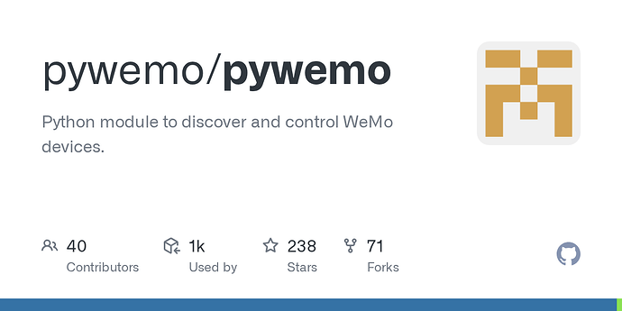

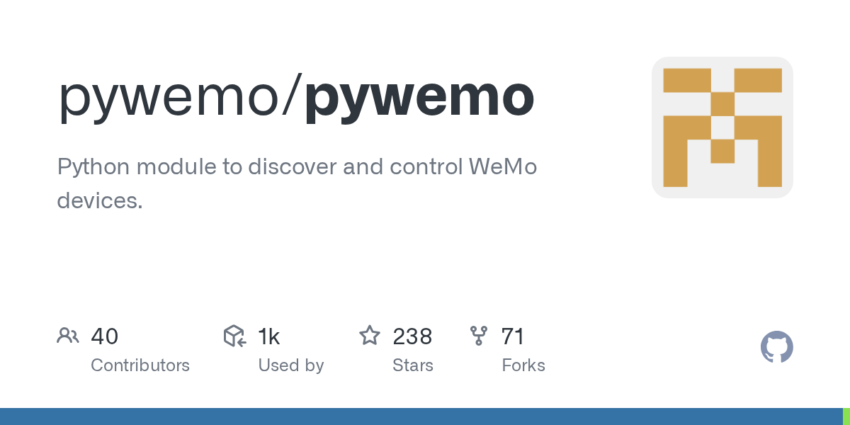

I have found some answers here… I think i installed the wrong Pywemo · Issue #803 · pywemo/pywemo · GitHub
And now have mine working.
