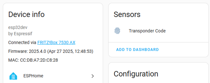

I’m trying to set up this sensor with ESPHOME for HOME ASSISTANT and an ESP32 WROOM 32D.
So far I’m unable to get any readings from the sensor, even if it appears properly in the Home Assistant Dashboard.
Anyone have already used this sensor and could give me some advice?
This is my current setup:
