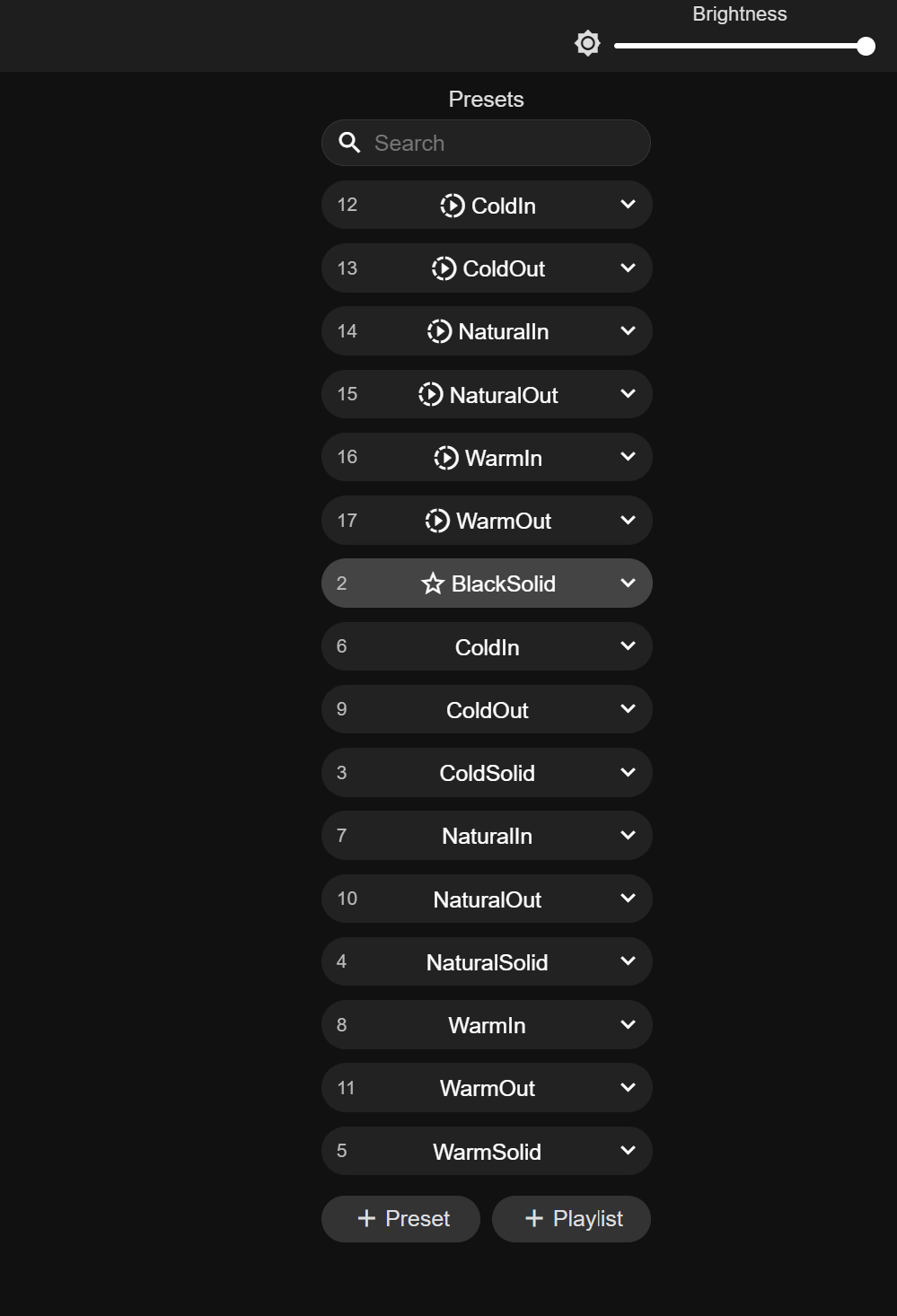

I’m not sure if this is the right spot for this topic, but here it is. recently I’ve build LED strip based on ws2511W and esp32-d1-mini. Board is flashed with latest WLED. Next I’ve added this to HA - and bam! everything is working great! i do some automations, having fun. next day i have added some new presets and playlists - but new ones did not appear in HA. I said ok, maybe there is no “refresh” functionality, so i will remove and re-add device to HA. I removed it accordingly to WLED integration documentation. Now when i tried to add it back I’ve got an error (screenshot from later testing - but error is same):

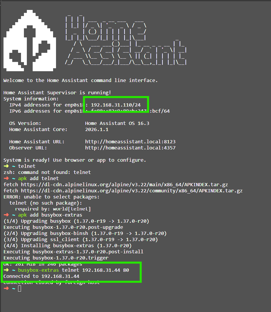

  • I’m able to access both web interfaces from PC
  • there is a network route access from HA to WLED IP on port 80:

  • Here my ideas ends, I’m not sure how to address this as my presets, and playlists work fine from WLED interface.
