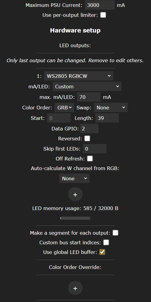

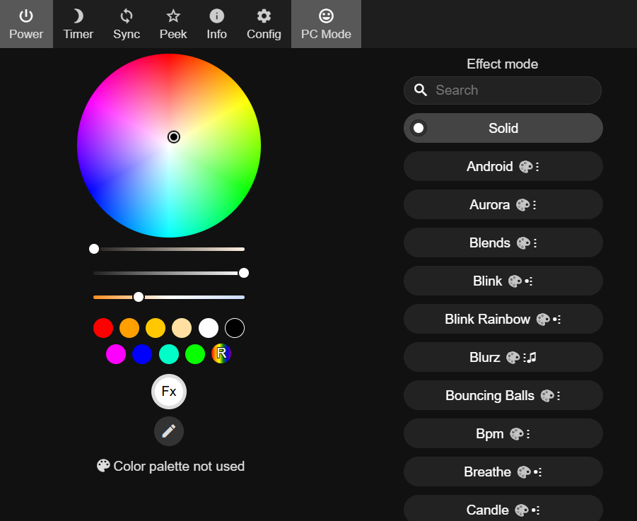

In WLED, this is how I’ve configured my RGB-CCT strip:
This config is a bit different for non-addressable LEDs, but WLED gives you the same controls regardless.

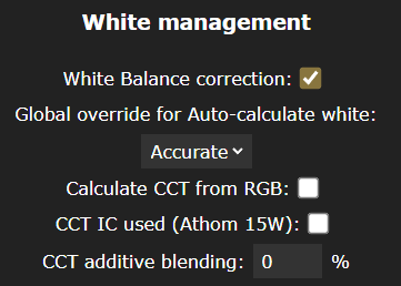

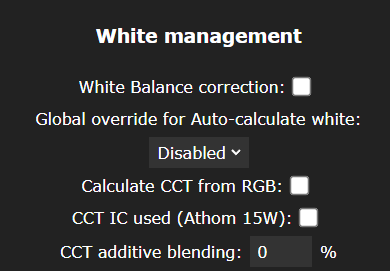

And this is the white balance setting:

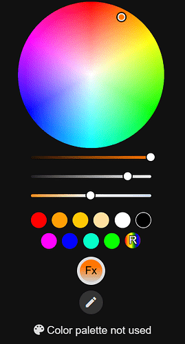

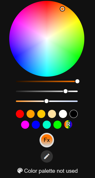

These settings result in a weird 3-slider UI:
  1. The color picker controls the RGB lights along with their brightness via the first slider.
  2. The second and third sliders control the brightness of both the white LEDs and the second is the color temperature.
This is pretty weird because the white color temperature and color LEDs are controlled independently in WLED, so you’d assume there’d be 2 separate light controls in Home Assistant or some way to combine them, but that’s not the case.

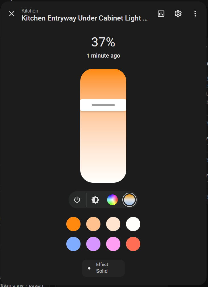

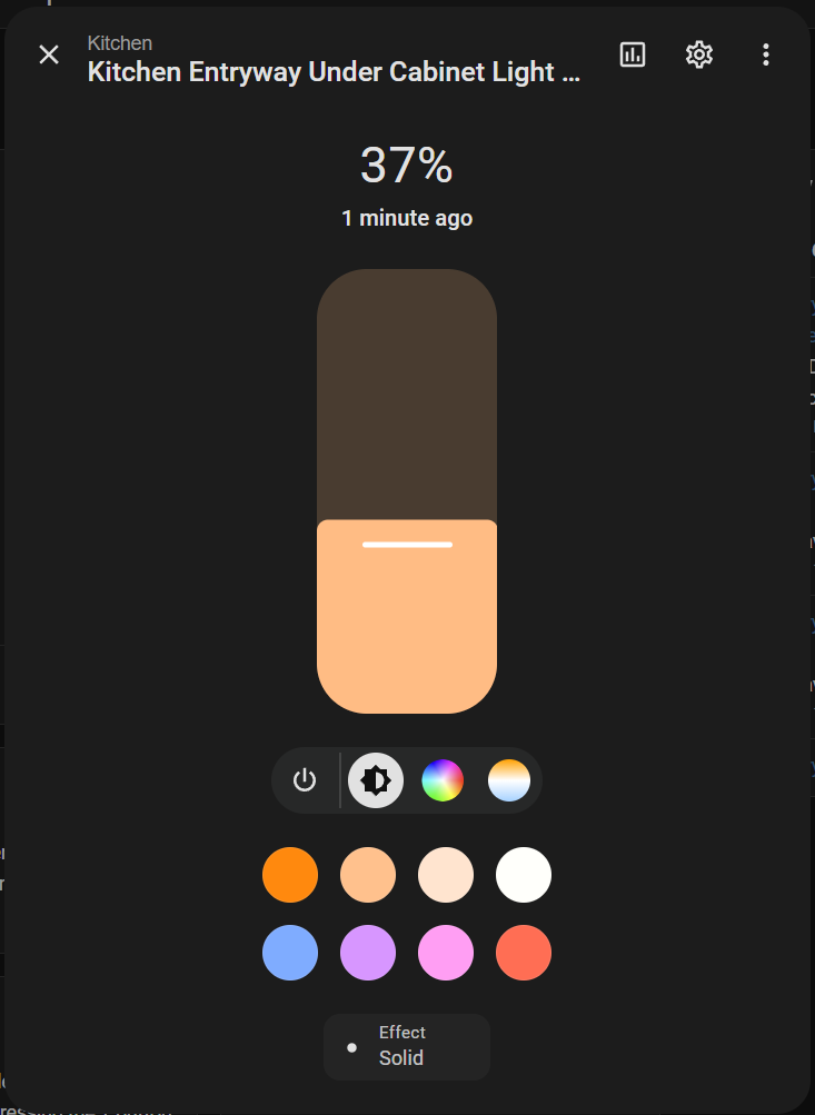

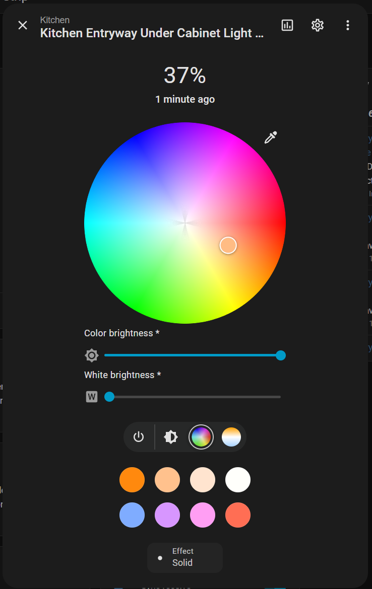

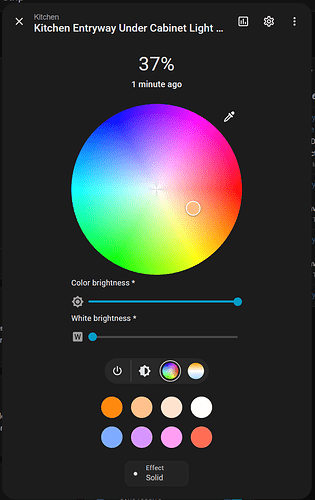

Home Assistant Light Settings

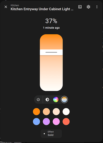

Home Assistant shows 3 screens like any RGBW light bulb:
  1. Brightness
  2. Colors (plus 2 other brightness sliders)
  3. Color Temperature
Everything works fine except the second screen (color picker). This adds 2 sliders below the color picker, one to set the color brightness and one to set the white brightness. These controls “work”, but after clicking anything, it immediately resets the UI back to:
  1. Middle-Orange (as pictured).
  2. 100% color brightness.
  3. 0% white brightness.
The Jank UI
You can still set these settings even if the UI keeps resetting, but sometimes, you have to click the color multiple times in a row for it to stick.
Sadly, setting the white balance in this mode will always turn the color to 100% brightness. Also, setting the color brightness to 0%, always sets the white brightness to 0% :frowning:.
Also, if you change the white balance, it won’t turn off the RGB LEDs. That’s the biggest issue. With a regular light bulb, if you only set the color temperature, the RGB colors go away, but with this WLED integration, they also stay on.

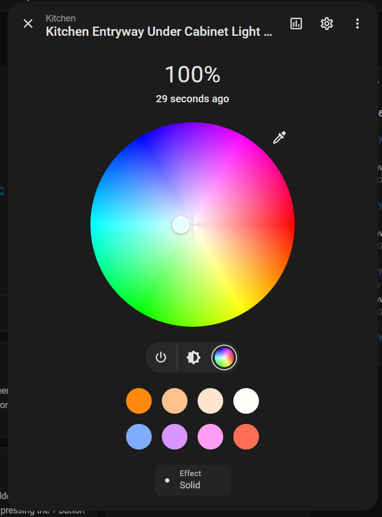

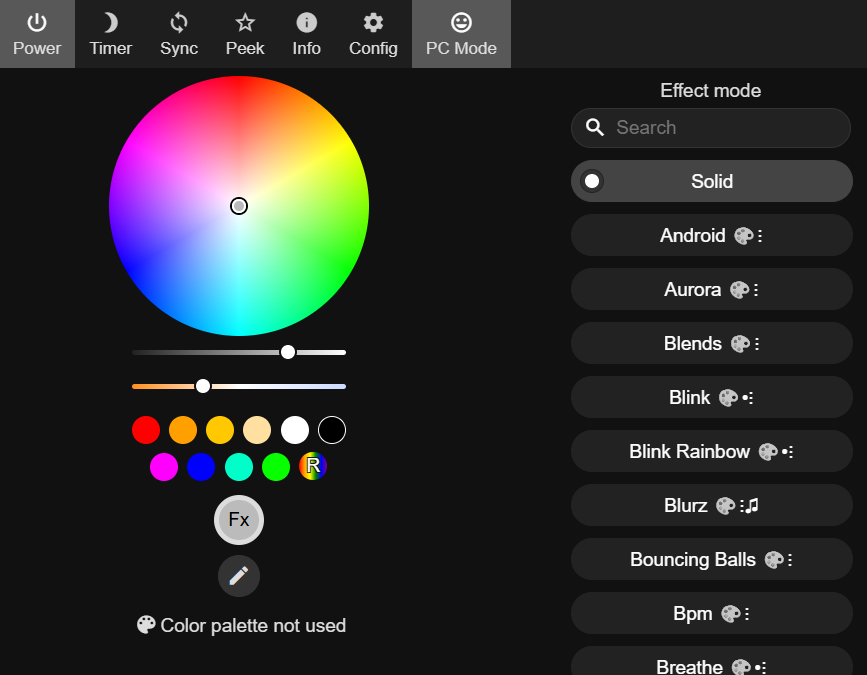

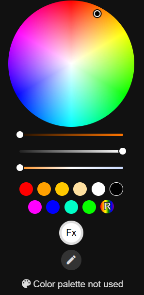

There is a setting in WLED to configure it such that you have 2 sliders. That looks like this:
From these settings:
The Big Issue

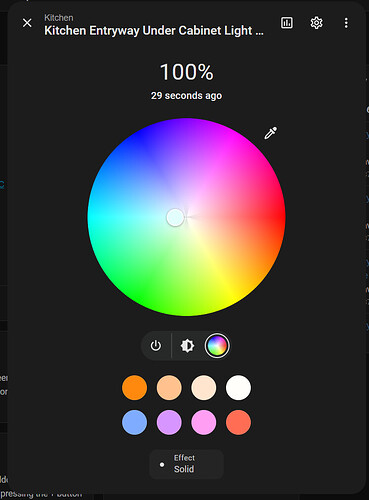

In this mode, you can set the white balance to separately control the white LEDs, but both colors and white are now mixed based on the color wheel. If you wanna completely turn off the RGB LED, you simply need to put the dot exactly in the center of the color wheel (100% white). You can also select “white” in the color palette for the same effect.
But now your RGB values are mixed with your white values when changing colors. It’s interesting, but now we have another issue:
Home Assistant no longer displays the Color Temperature screen. You can change RGB values, but color temperature is outta the question. This is also bad because Home Assistant is now going to approximate the color temperature using color values.
“Calculate CCT from RGB” not a fix
I verified, that even when using the “Calculate CCT from RGB” setting, the RGB LED will always be active unless your RGB value is 100% white. And in this mode, Home Assistant cannot control the color temperature separately like WLED, so it’s basically unusable.

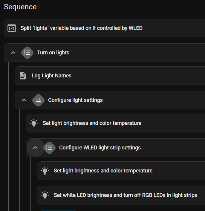

After writing that post, I realized there was possibly a way around this issue using RGBW. It doesn’t fix the UI, but it does fix my automations (the most important thing right now as the light strips are already installed).
Hacky Workaround
Here’s my hacky workaround for white that you can use today:
This is really funky, but I split the lights into 2 groups: ones controlled by WLED and ones not controlled by it:
alias: Split `lights` variable based on if controlled by WLED
variables:
  regular_lights: |
    {{ expand(lights)
       | rejectattr('name', 'search', 'Light Strip')
       | map(attribute='entity_id')
       | list }}
  wled_lights: |
    {{ expand(lights)
       | selectattr('name', 'search', 'Light Strip')
       | list }}

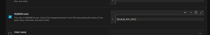

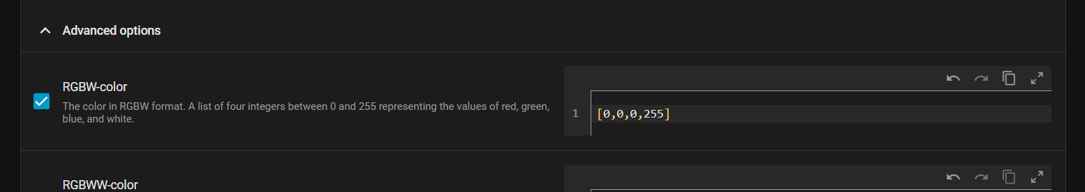

I then do parallel actions for turning on the lights. For the strips, there are 2 steps:
  1. Turn them on as usually with Kelvin and Brightness (that controls the global brightness, not the segment brightness). I do this with no transition set so it happens instantly.
  2. Then I call light.turn_on a second time which overrides the first one and this time, I use RGBW to set all RGB colors to 0 and the White brightness to 255 ([0,0,0,255]). While that looks like I’m setting it to 100%, remember, the global brightness control from the previous step will handle the actual brightness setting. This brightness value is more like a luminance-hue-saturation control, and you want that set to what is essentially 100% for white.
alias: Configure WLED light strip settings
sequence:
  - alias: Set light brightness and color temperature
    metadata: {}
      brightness_pct: 100
      kelvin: 3500
      entity_id: "{{ wled_lights }}"
    action: light.turn_on
  - alias: Set white LED brightness and turn off RGB LEDs in light strips
    metadata: {}
      rgbw_color:
        - 0
        - 0
        - 0
        - 255
      transition: 1.5
    enabled: true
I had to update all my other scripts to target my new script. It’s possible I missed some places :man_shrugging:. This is super hacky as it is.
To be clear, this only works for automations or dashboard buttons that call this script. This doesn’t work for the UI. That’s still totally busted.
If I have any scenes that need light strips set a certain way, I can simply modify those in WLED and store the scene with Home Assistant.
