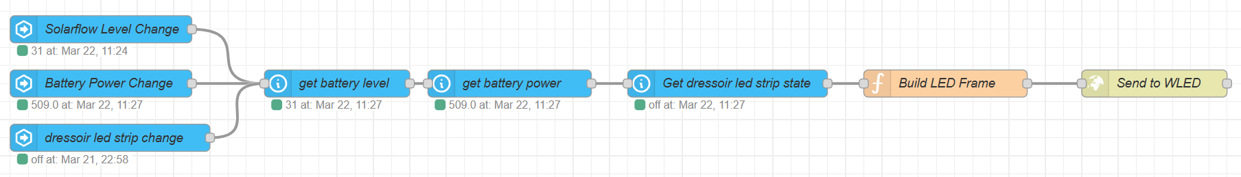

:jigsaw: Flow Diagram
:brick: Node‑RED Flow (import‑ready)

Here a picture of battery at +- 75% and discharging (red color), no indirect lighting active
![WLED_battery_indicator|666x500](upload://72OIm8ds417ZzG2z1gaJVZiPKFV.jpeg)
