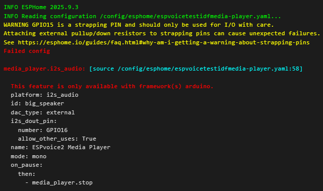

My problem is that if I use the Arduino Framework I can have “media_player:” or “speaker:” but if I choose esp-idf the yaml checker will say there’s no “media_player” component.
The yaml below has both versions, just the “speaker” commented out because I want the media_player. If I change framework to esp-idf it won’t build with media_player, only if I switch the relevant lines to “speaker”.
It’s possible I’m missing something; if so, please tell me what.

The code above builds fine.
If I change the platform lines like this:
esp32:
  board: esp32dev
  framework:
#    type: arduino
    type: esp-idf
    version: recommended
I get this:
Well?
If you read the link I sent above you will see you need this code for it to work.
