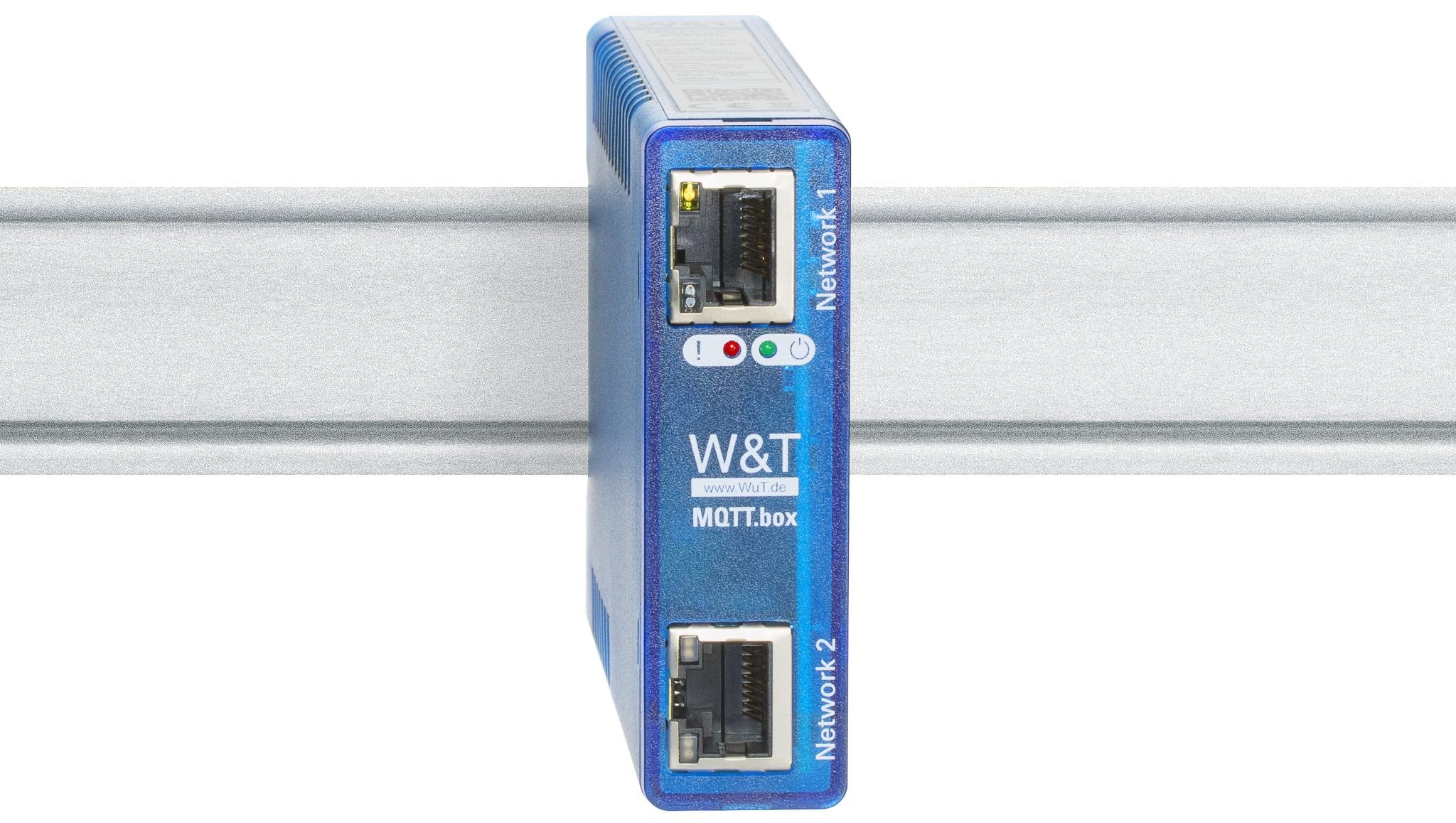

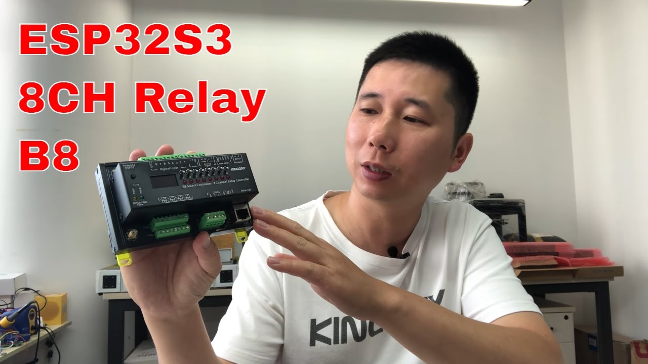

There is this:
and then this:
You would need to make something for that product line that sits in a competitive price range.
You’re right, after looking better at the KinCony lineup, the KC868-AI in particular is already very close to the generic idea I had in mind: DIN rail, 48 opto-isolated inputs, Ethernet/LAN, MQTT/ESPHome/Home Assistant support, etc.
So maybe a generic “wired input module for HA” is already too well covered.
