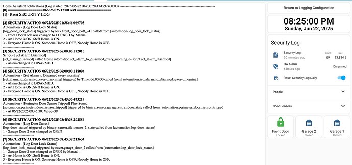

I write ALL my own log files, simply because it’s much easier to use than the built in options. I am willing to share the code with you, just know that you’ll need to use a couple add-ins to use to the full potential. I have added an example of the RAW data I write to one of my logs. Security Log in this case. All data is written to a txt file, and that data is the displayed in the front end, dynamicly update. All logs can [optionally] be purged overnight to reduce file sizes. Incorporating it into your existing code requires a few lines of code and is very flexible about what you can pass to the script that builds the raw data. On my system, I write to 11 different files, with data sorted by topic. For example Security, HVAC, Media, Maintenance and so on. This allows me to log as much or as little data as I need, all into one concise file by topic.

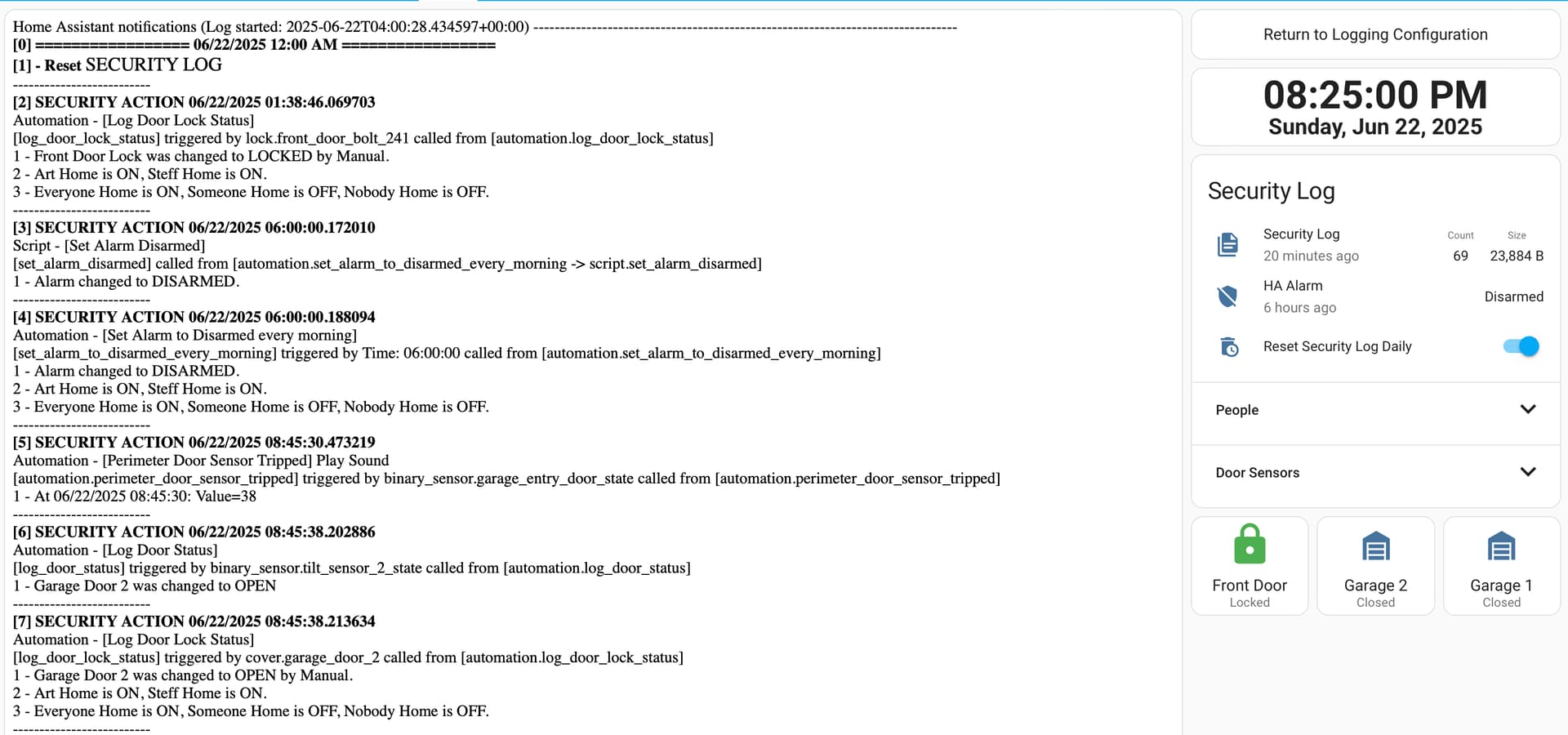

And what it looks like in the front end:

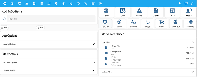

This is the main control section for all logged data:
As I mentioned, it is a bit of a task to get all the parts and pieces configured, but once you understand the workflow, adding additional logs is a piece of cake.
Please send me a private message if you are interested in doing this. I will go over all the required components, steps required to set up the notify services and code blocks that need to be inserted into your existing code. The scripts and automations do all the dirty work as well as the maintenance required. You just need to be willing to invest the time and effort to put it all together.
