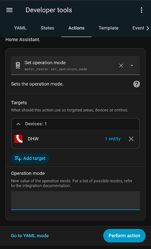

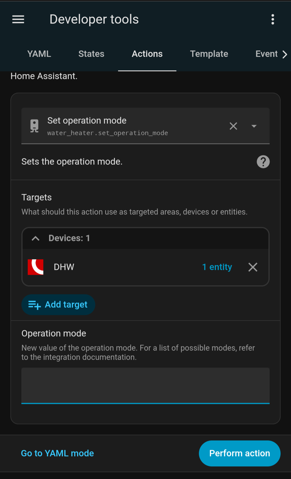

i am using the Luxtronik Integration by BenPru.
This Integration has a Controll called DHW Domestic Water.
With Mode you can select the operation mode oft the HotWater HeatPump=Automatic Mode, Performance=PartyMode
Is there a way extract this Mode Button?
I dont need the rest of the control.
In the manual it is described to use a service.
But not where to Implement it.
In order to change parameters on the Luxtronik conroller, you can use the following service:
Domain: luxtronik2
Service: write
Service Data: {“parameter”: “ID_Ba_Hz_akt”, “value”: “Automatic”}
Can you please help me?
It’s not exactly clear to me what you want to achieve.
The entity had a number of attributes you can use:
You can use a template to retrieve these attributes using a template sensor.
There are actions to control the operating mode. Actions can be used in an automation.
I hope this points you in the right direction and if not, let us know.
