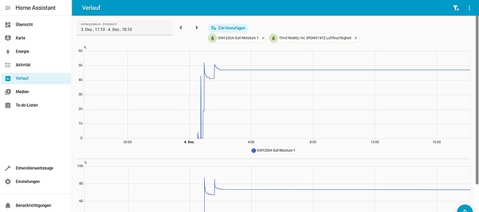

My problem is that the charts in Home Assistant are showing incorrect timestamps, even though the correct time zone is selected in the settings. For example, it might currently be 6 PM, but when I add water to the soil and the measurement changes, the chart logs this change as happening at around 1 AM.

Yes, you need a RTC or a locally available NTP server :mantelpiece_clock:
Hello jawid-jafari,
So 5hrs different?
Are you in US Eastern timezone?
You are probably looking at UTC time used bu the database and possibly something is messed with your time zone settings, don’t know.
