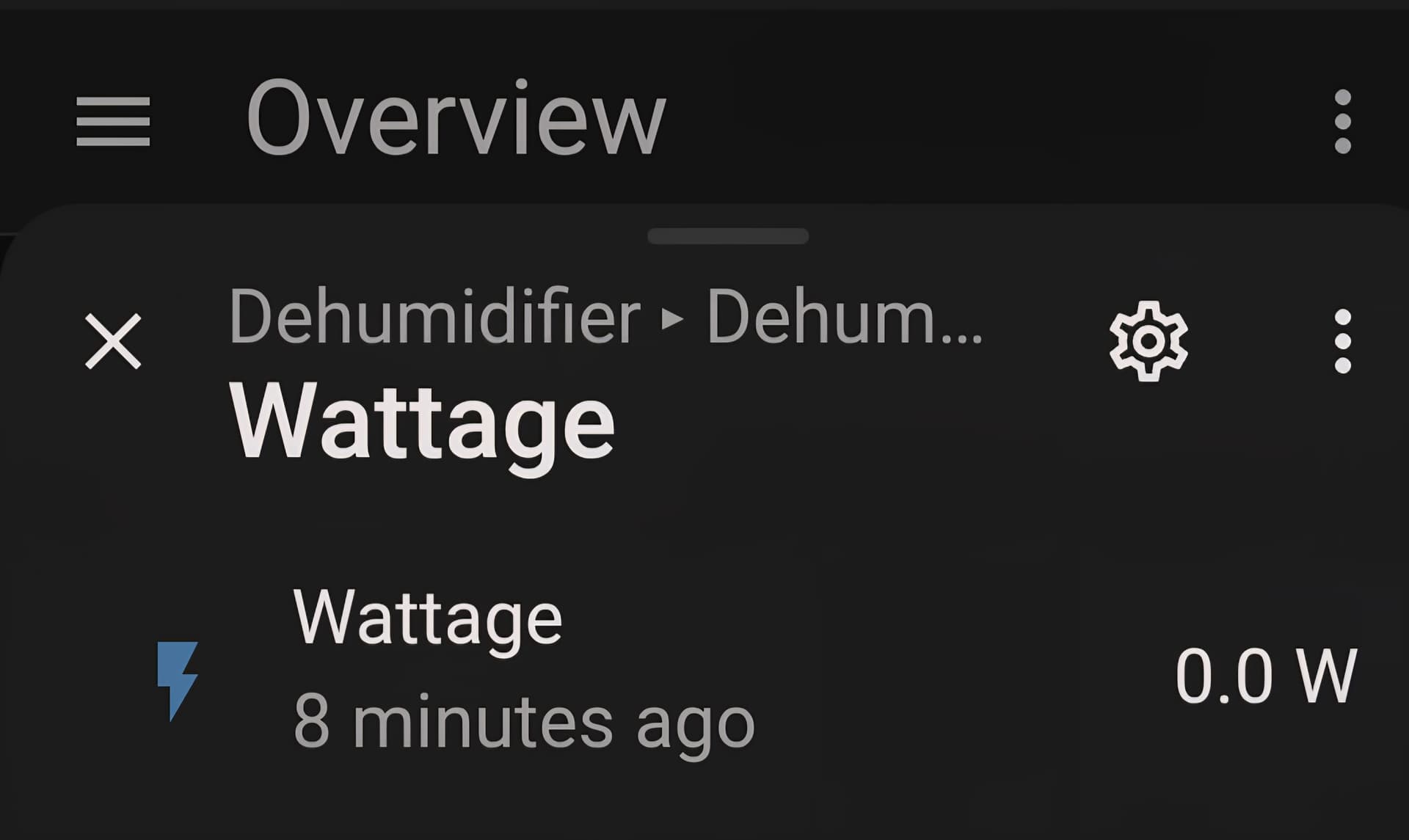

HA entities no longer have a link to show a graph of past values, such as, 2 days by default, selectable Today, Yesterday, Week and more. I read the release notes for 2026.4 and 2026.3 in their entirety, but don’t see any mention of this. 2026.3 was a big UI change, but I didn’t notice the loss of the entity graphs until today. They were there a day or two ago.
To be clear, I’m referring to the graphs available on Overview > [click an entity] > graph icon left of the gear icon is gone.

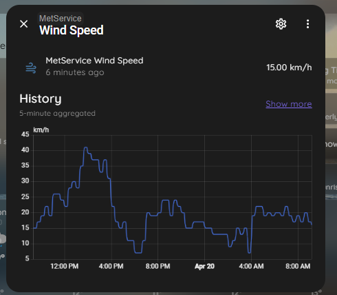

do you mean the following?
az_recorder_20260419_203517
Yes. I lost access to those graphs. The link is not on the entity screen. The video is too fast to see the first screen.

I don’t get to that screen on any entity. My entities no longer have a graph icon left of the gear.

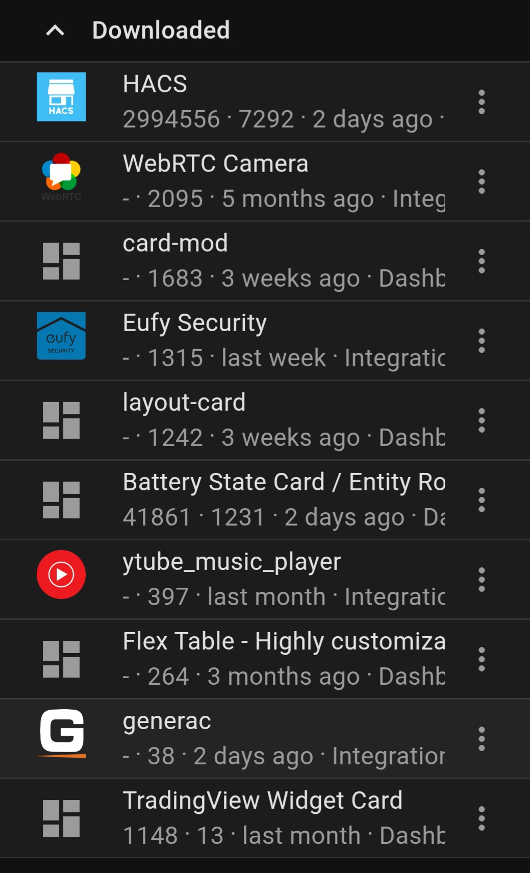

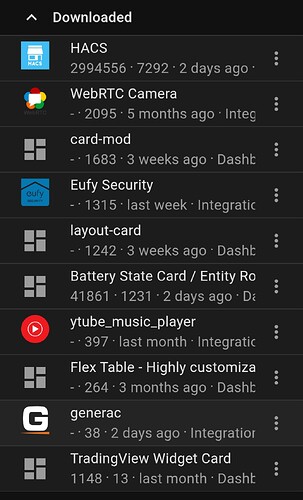

Here are my HACS downloads:

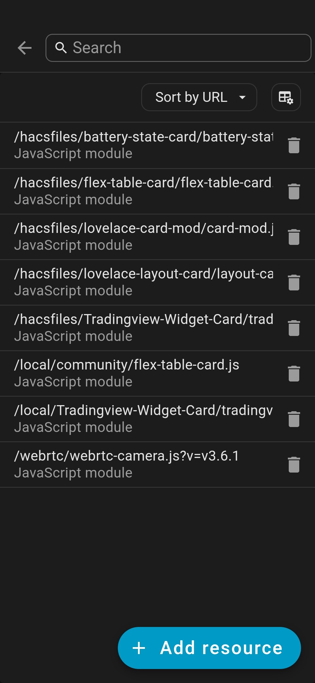

Here is what is in config/www/community:

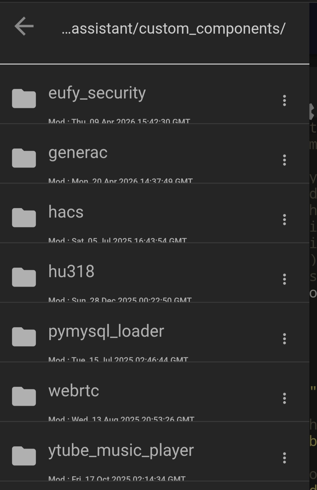

Here’s what’s in config/custom_compontnts:
All your entities or just one? Are there recorder errors in your logs?
All entities. I have no recorder exclusions.
