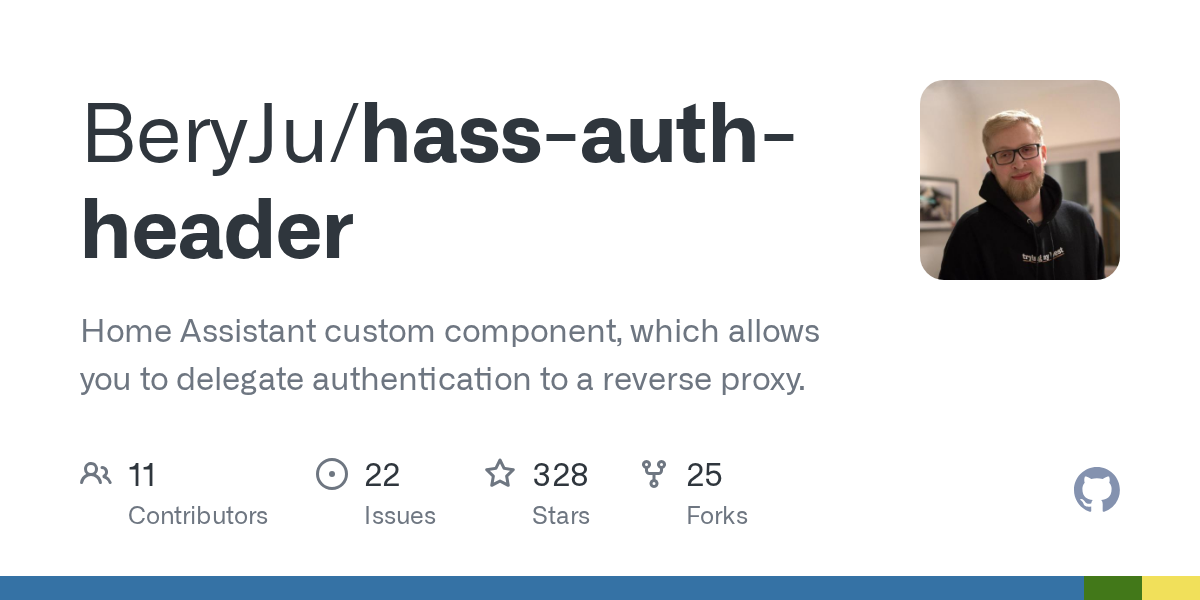

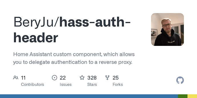

adding
to HACS
and setting
auth_header:
  username_header: Remote-User
AND making sure that the HA user == pangolin user now enables me to use pangolin for sign on and connect to my HA instance remotely without being prompted for a password.
This is about 60% of where I would like to be in terms of SSo but better than nothing. Since I did not find anything about HA + pangolin I hope this post can save someone on the internet some time to figure out the details. Especially the proxy part caused me some headache since it is a bit counter intuitive first. But if you think about the architecture with the wireguard tunnel it actually makes sense.
