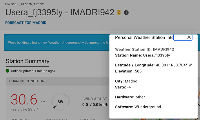

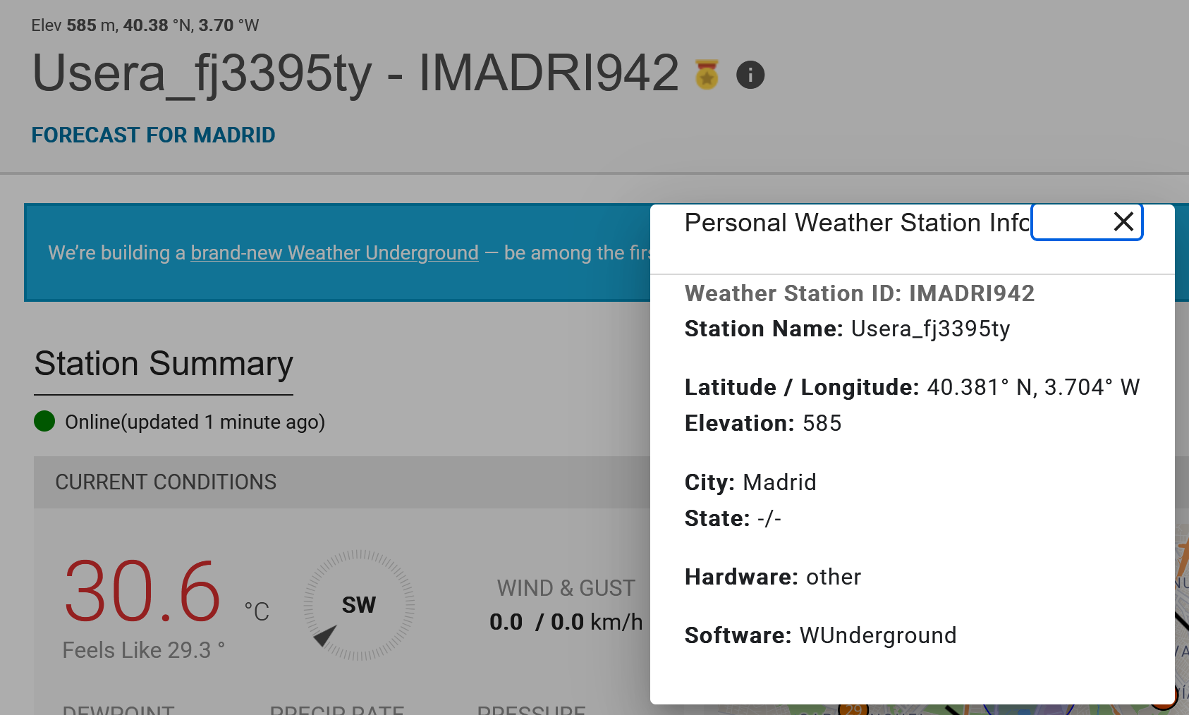

Hi. Thanks for this fantastic blueprint; it's allowed me to upload my data from a Tuya station that didn't have direct integration. Checking neighboring stations, I noticed that some provided information about the software used, so after some research, I found a "softwaretype" parameter in the payload that enables this. I modified my copy to include it, and it's working. If you'd like, you could include it in your master blueprint.
