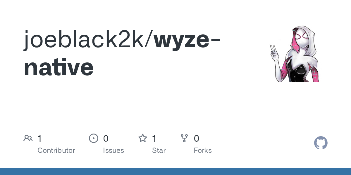

I’m sharing Wyze Native, a custom Home Assistant integration that talks directly to the Wyze cloud API (async, pure Python) and exposes Wyze cameras as Home Assistant entities.
Repository:

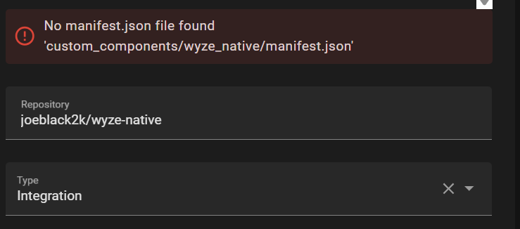

When I try to add the repository to HACS, I get the following:

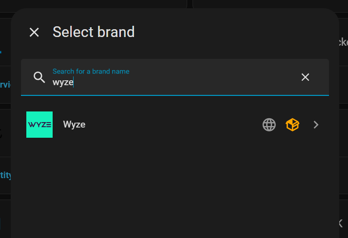

If I add it manually, after a restart of HA, it does not appear as an available to install integration:
Advice?

Thanks for reporting this — you were right.
Root cause: manifest.json was missing from the repository root path that HACS validates (custom_components/wyze_native/manifest.json).
This is now fixed in main:
Please do:
  1. Reload HACS
  2. Re-add the custom repository
  3. Install the integration
If HACS still caches the old result, remove and add the custom repo once more.
