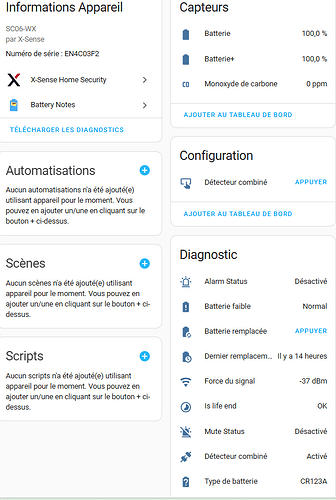

I set up the X-Sense SC06-WX combined detector.
The integration is working correctly, and the entities are showing up, but it seems like the “smoke detector” sensor is missing.
Only the “carbon monoxide detector” is appearing.
Additionally, the “Mute” button is also missing.
Is this a feature that needs to be implemented?
Thanks in advance.
Issues : Issue with X-Sense SC06-WX Integration ? · Issue #39 · Jarnsen/ha-xsense-component_test · GitHub

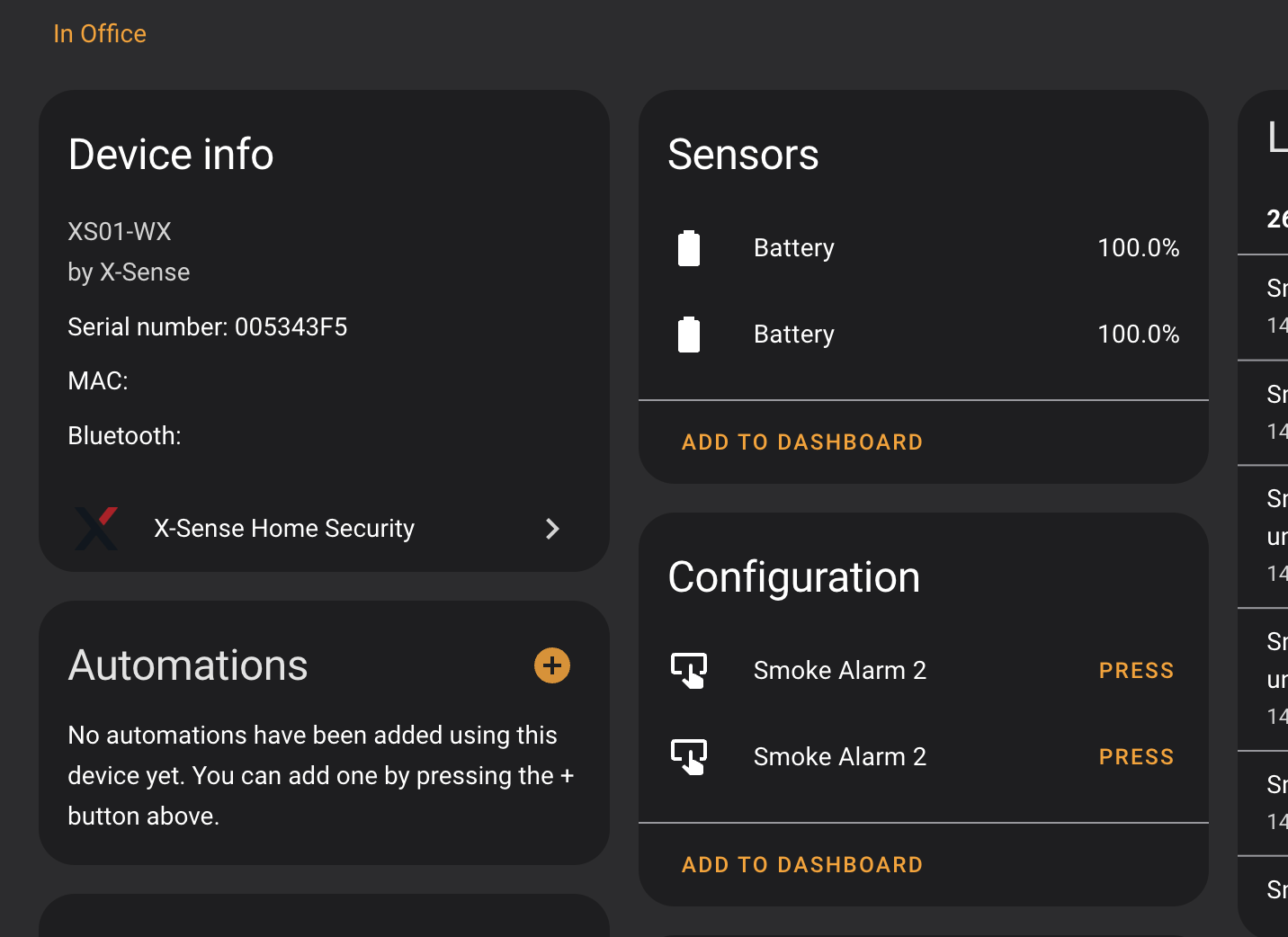

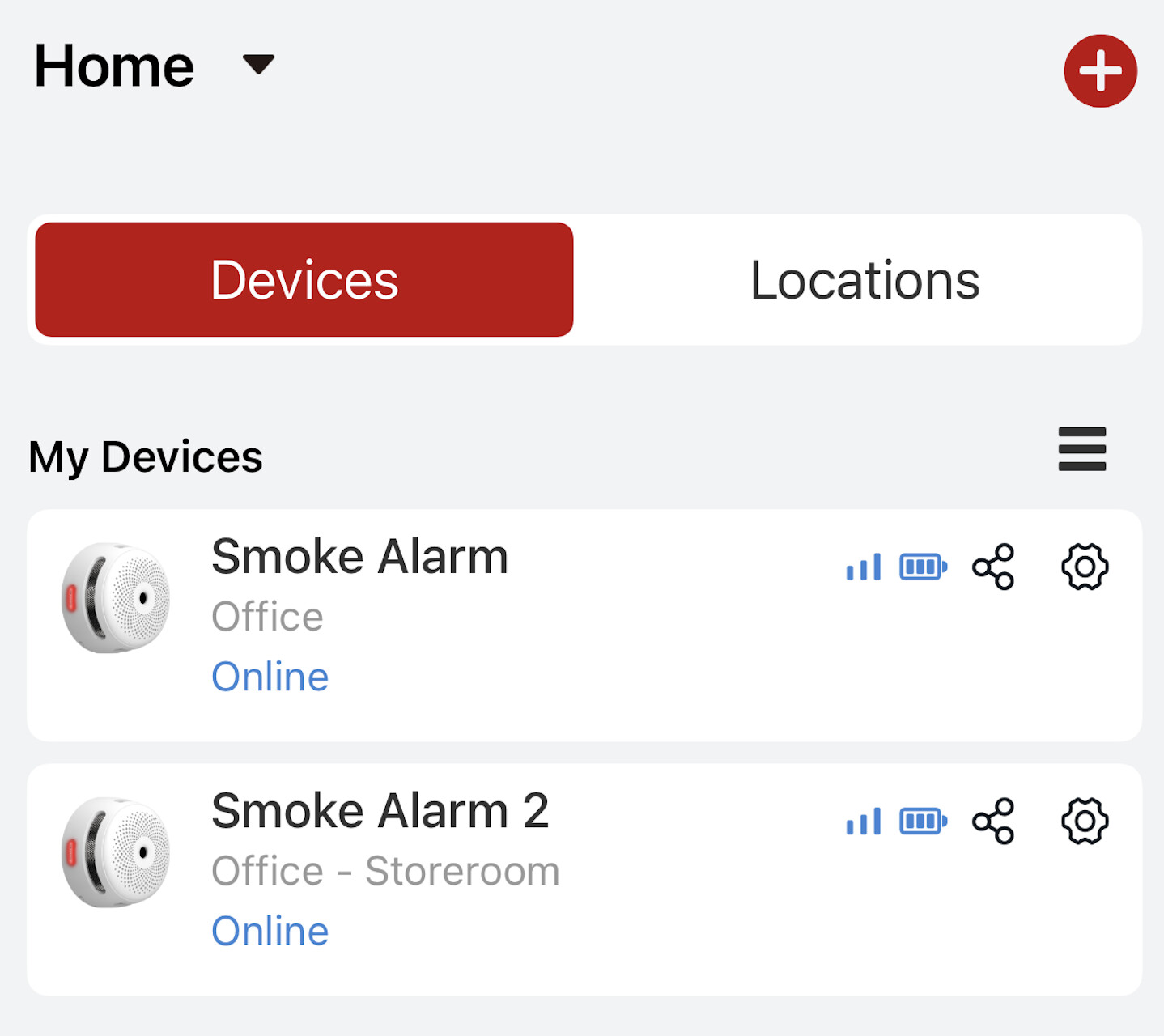

Hey Everyone.
Just playing around with this integration at the minute.
I have 2 x XS01-WX units.
The issue i have is when i set up the integration in HA - i get a repeat of the same device (x2).
In the App i see 2 different devices, however on the integration, i see one device (both with the same name as each other) - so i cant set up any routines/alerts based on the individual devices.
Screen shots attached:

Hello
I have the same issue with 2 of my smoke Detectors : XS01-WX
Have you found a solution ?
Many thanks
Nick
Hi Nick
Unfortunately not - I’m to the point of replacing them already with Aqara instead :frowning:
