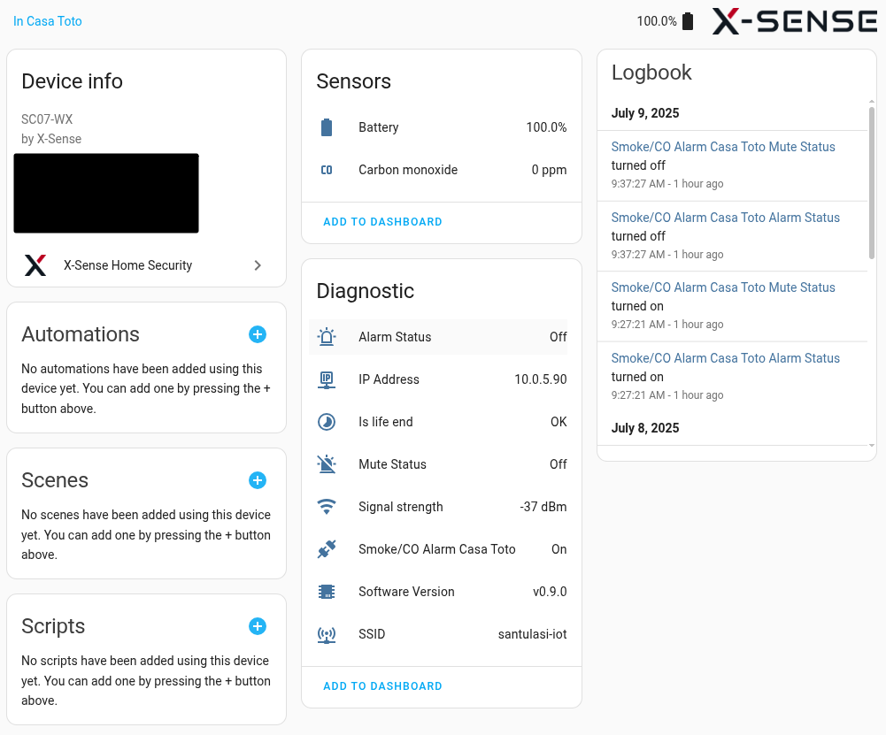

Just purchased two SC07-WX smoke/CO alarms for my small business because of the existence of this integration (thank you @theosnel and @Jarnsen!). Would like to buy more of them, start setting up automations and ditch the X-Sense app eventually. I see a few issues and missing features, some of which have already been discussed here, but I wanted to put them all together in a post for new people intending to buy this device and to use it with HA:
  • HA entities don’t get updated fast enough for an emergency device (minutes of delay!): as a workaround I set DEFAULT_SCAN_INTERVAL=15 in custom_components/xsense/const.py
  • No silence button
  • No test button and test status
  • The Alarm Status entity actually represents the presence/absence of smoke and not of a generic alarm: therefore it should probably be renamed and assigned class “Smoke”, given an appropriate icon and moved from the diagnostic to the sensors section. I tested this by triggering a CO alarm and observing the entity remaining Off (Carbon monoxide entity showing ~900ppm)
  • Testing whether the entity with the same name as the device (plug icon) represents the online/offline status: if so it should probably be named accordingly
  • Battery entity in diagnostic section?
  • No local control :smiley:

The entity with the plug icon for the SC07-WX doesn’t seem to represent online/offline status. It is On even when the device is Offline in the X-Sense app. It only turns Off for a short while when reloading the integration. Does it only represent connection to the X-Sense cloud from HA?
And since there is no generic (smoke or CO) alarm status entity, one may be created with a simple binary sensor template such as
{{ states("binary_sensor.smoke_co_sensor_smoke") == "on" or states("sensor.smoke_co_sensor_carbon_monoxide")|float > 30 }}
This however does not represent the true alarm status, since you can have CO > 30ppm for a while before the CO alarm is triggered. In fact, there is also a “CO Alarm Precaution” state that may be entered before the actual alarm.

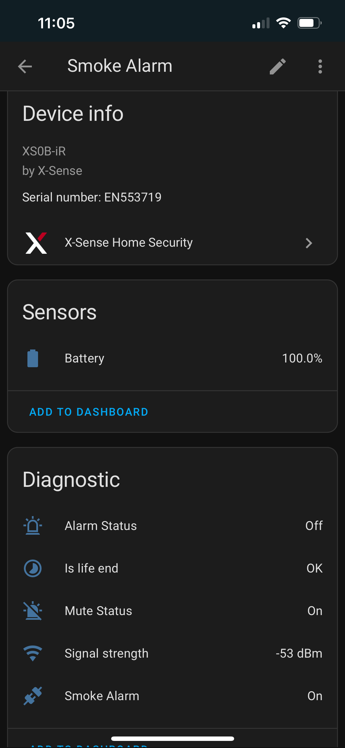

Hi Guys
I have added a (new model?) smoke alarm:
XS0B-IR
Does this look correct? I assume “Alarm Status” goes to on if the smoke alarm is triggered. Does anyone know a way to test if this is working? The standard test (pressing the self-test button on the unit) doesn’t shift this sensor.
Otherwise i’ll try burn some paper :joy:

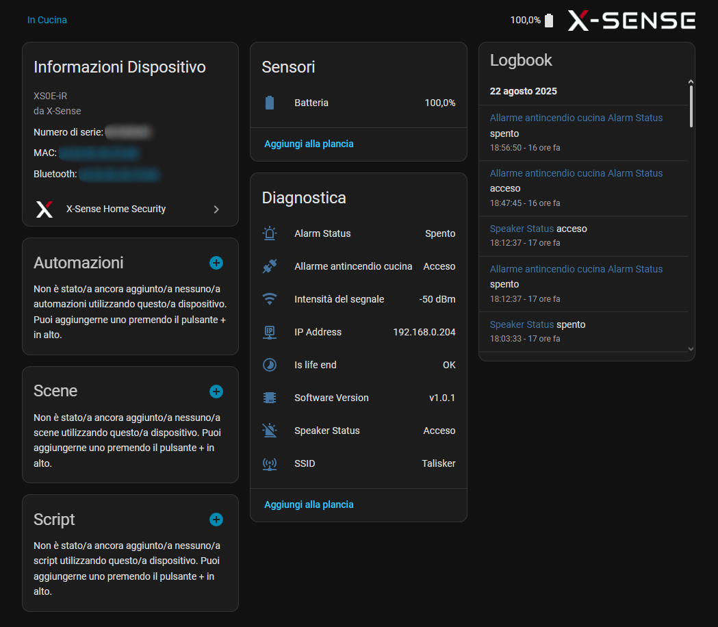

XS0E-iR smoke detector added.
I had to modify DEFAULT_SCAN_INTERVAL as suggested by @c-gabri since the alarm notification was too much delayed.
