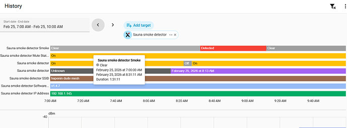

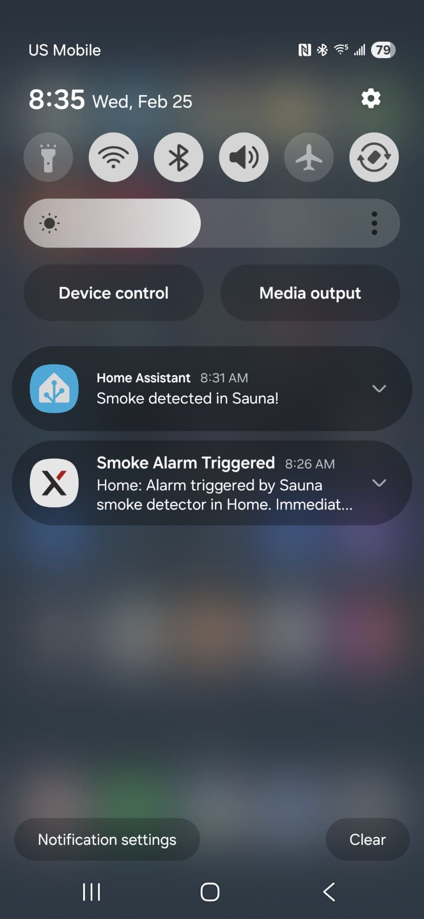

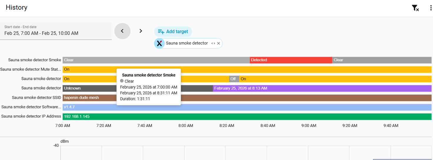

I also have the XS01-WX Smoke Detector (battery operated). After installation, they show up as entities, but while testing with real smoke, they do not update in HA. However, the X-Sense app does update and issues notifications. I saw some posts that people here got it to work, but yours is the most recent and it seems yours don’t either. Did you ever figure it out?
Hi Theo, thanks so much for your great work! I have been waiting for this feature to be added for quite some time. In my setup, running version 1.0.18, the test button for the XH02-M heat sensor is still missing. Should your update already be contained in this release or will it be part of a future release?
After more testing, I got it to work. Once. But it took 5 minutes from when I got the notification in the X-Sense app to when I got the notification in HA through this integration. Strange. Then I tried repeating the test and no notifications after several hours. Also, the smoke detector status does not update. I removed the battery around 9am and as you can see, it thinks the detector is still on.
I have 3 Smoke detectors talking to HA via mqtt but my new sws51 leak detector isn’t discovered.
Is there a new firmware for it yet?
Well, I finally got two more notifications. 5 days later. Any idea what could be going on?
