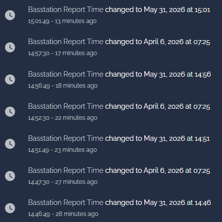

Working great! The only thing ive noticed is the activity log filling up with these?

This was fixed in the latest version. I mentioned that on github, just mentioning it here too.

Thanks for reporting this. v.1.2.4 should stop the base-station report-time entries from filling the activity log.
Please update and let us know if the log noise is gone.

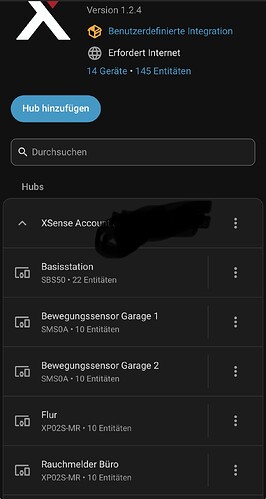

Ich habe 14 Geräte und zwei Kameras, die Kameras werden immer noch nicht angezeigt.
Lets stick to this pls so all can participate/respond......
I have 14 devices and two cameras, but the cameras are still not showing up.
