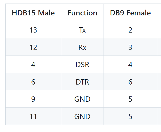

Hi @cwelsh1812, since I can’t get the USB to serial cable to work, I decided to get a Global Cache IP2SL for another round of testing. Two questions:
1- Which type of cable do you use between the IP2SL and the Xantech?
2- Which port do you use on the Xantech (front or back?)
Thank you!
IP2SL is now connected to the network (192.168.x.x) and I have built the recommended DB9 to DB15 cable
My configuration
