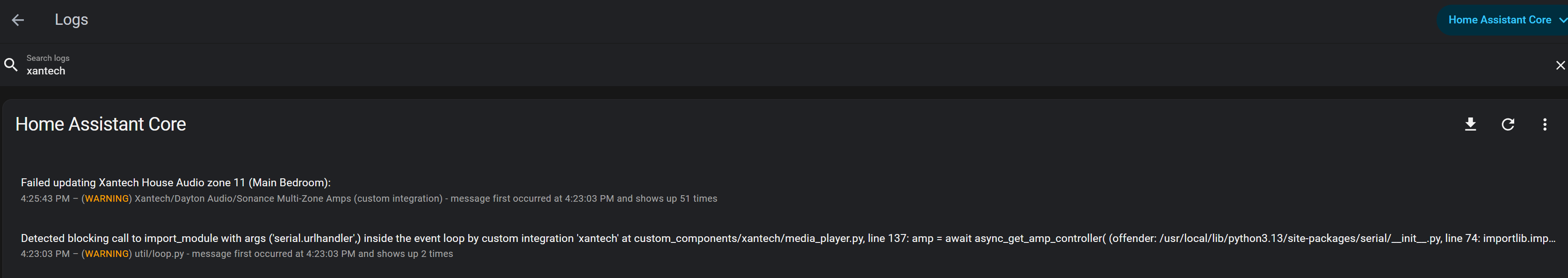

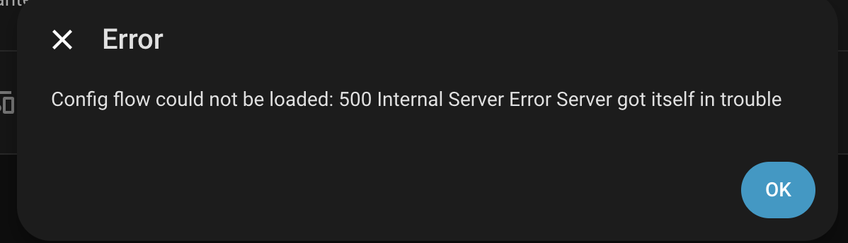

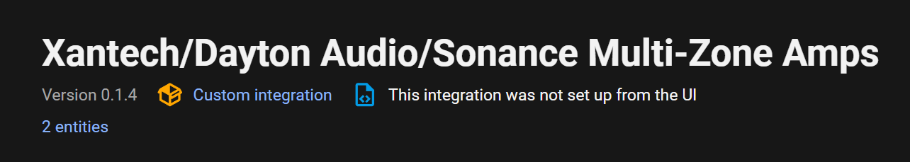

I am able to install v 0.1.4:
but still get errors and can’t connect:
Any troubleshooting advice? Thank you!

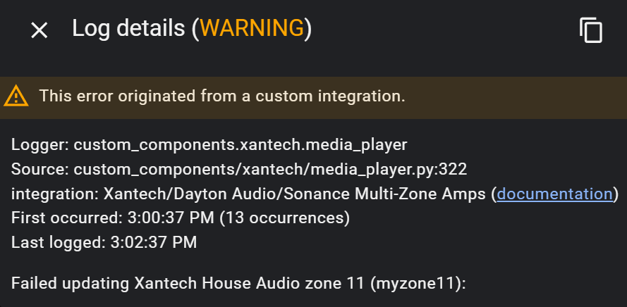

When connecting the MRAUDIO8X8 to a Windows PC (USB to serial cable), I am able to communicate with the unit using Universal Dragon, turning zones ON/OFF, etc. I was even able to upgrade the firmware.
With the upgraded firmware + HA with the same usb-Serial cable, I only get this error (I’ve tried both 1,2,3, etc and 11,12,13, etc as “zones:”)
configuration:

I am still, however, seeing errors like these:
2025-09-28 07:13:23.782 WARNING (MainThread) [custom_components.xantech.media_player] Failed updating Xantech House Audio zone 17 (Garage):
2025-09-28 07:13:26.417 WARNING (MainThread) [custom_components.xantech.media_player] Failed updating Xantech House Audio zone 18 (Family room):
2025-09-28 07:13:35.749 WARNING (MainThread) [custom_components.xantech.media_player] Failed updating Xantech House Audio zone 13 (Kitchen):
2025-09-28 07:13:39.701 WARNING (MainThread) [custom_components.xantech.media_player] Failed updating Xantech House Audio zone 15 (Primary bedroom):
2025-09-28 07:13:41.565 WARNING (MainThread) [homeassistant.components.media_player] Updating xantech media_player took longer than the scheduled update interval 0:00:10
I want to reassure @Montreal666 that these issues seem (in my case) to be non-fatal.
I want to ask, @ryans, is it expected that these messages say (MainThread)? Is that an issue?

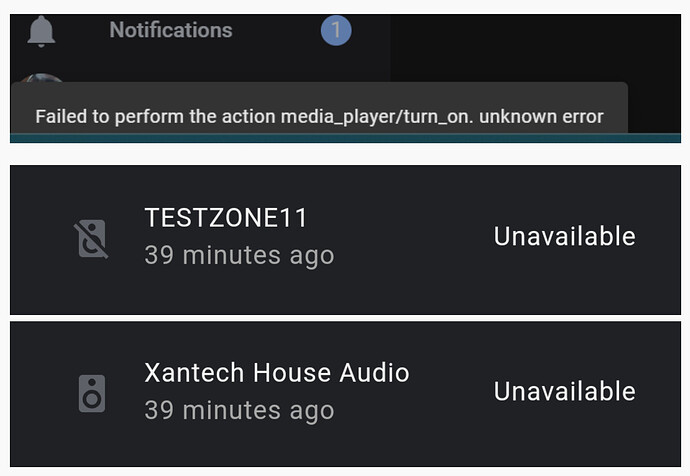

Thanks for the feedback @sorrygofish, however in my case entities are created but I can’t control the unit (“failed to perform the action”)
Would you mind providing screenshots of your entities so I can compare to mine? :

My entities show up properly:

I am not able to control the volume of my speakers through HomeAssistant via my DAX-88. The speaker entity has a dropdown of my sources and a button to turn on the zone, but doesn’t toggle on/off. And like I said, I have no way to turn the volume up/down through home assistant.
I may have to remove and re-setup the integration. Let me know what would be most helpful.

  File "/config/custom_components/xantech/config_flow.py", line 243, in async_get_options_flow
    return XantechOptionsFlow(config_entry)
  File "/config/custom_components/xantech/config_flow.py", line 251, in __init__
    self.config_entry = config_entry
AttributeError: property 'config_entry' of 'XantechOptionsFlow' object has no setter
