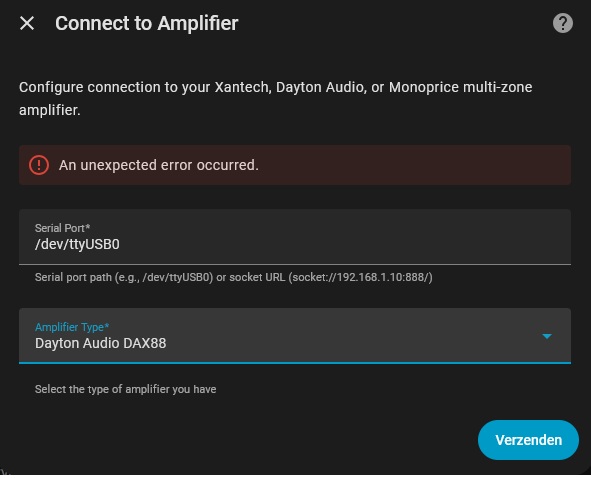

I get the following error message, what steps did you take to get the dax-88 working?
I removed the integration under the devices and services, and re-added it. My screen looked exactly like yours, except the unexpected error did not occur for me.

I still get the same error. If I remove it from my configuration.yaml, the error remains the same.

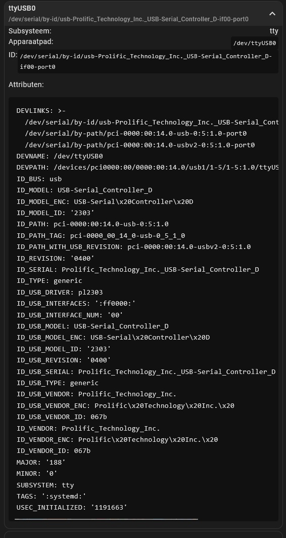

When I look under the hardware tab it is definitely the usb0 that I should use.
I removed the media_player portion from my configuration.yaml. I’m just using the integration under the devices and services

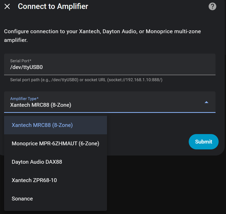

The new UI, doesn’t list MRAUDIO8X8 as an option, should I assume it is not supported?
Did you have a chance to test your MRAUDIO8X8 with this version? (not working here - using MRC88 option)
I keep testing when new updates come out, hoping to solve the issue with my unit (communication/control works with stock tools like Universal Dragon so I ruled out hardware issues)
Thank you!
The MRC88 should work identically to the MRAUDIO8X8 (same RS232 commands for both). Was it working before and not working now?
I am updating the list of devices to show all the variations of model numbers, should be visible in next release.
