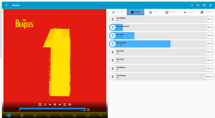

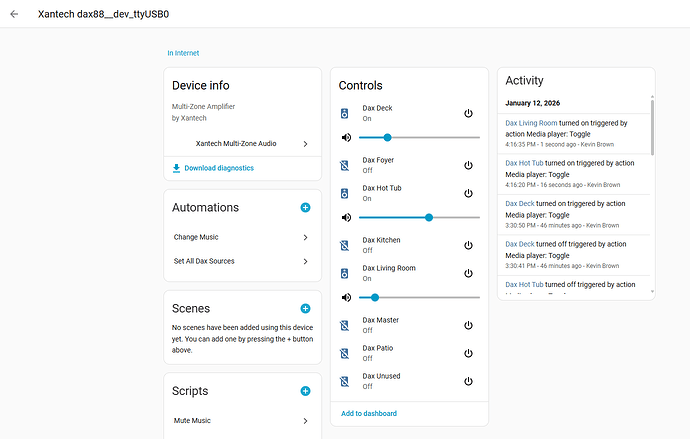

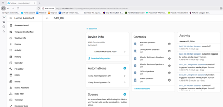

I have everything working on my DAX-88. Volume controls work, on/off works through scripted commands, but the UI doesn’t seem to poll the status of the speakers. They always show that they are off, even though they are on. I can toggle them on and off, and they show as on for a few seconds, then revert to showing that they are not on. My kitchen and living room speakers are physically on in this screenshot

I do not see this … mine shows them correctly.
I could see this being an issue if you had the original installation.
What does the generic entities view show?
I had a set of duplicates … one from old and one from new with different IDs.
I had to delete all the old ones by hand.
Living Room, Deck and Hot Tub on … different volumes …
Mapping to my card 100%

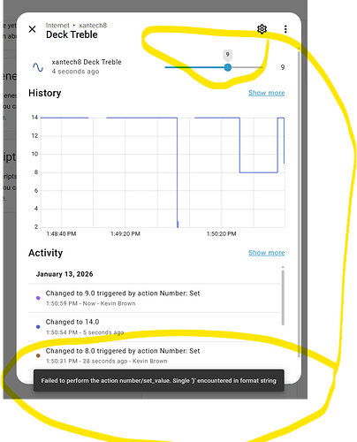

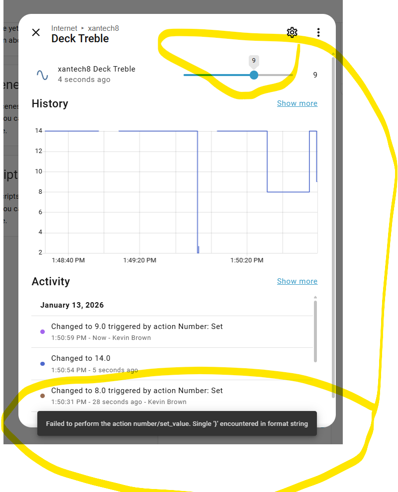

I just did it and all OK except there is a bug in TREBLE setting. I know my old code had an extra “}” and I think yours does too …
I was getting the config flow error but changing line 277 in config_flow.py to:
self._config_entry = config_entry
seemed to solve it
Confirmed.
But at least for DAX 88 … Treble setting is an error that the command has ‘}’ in it

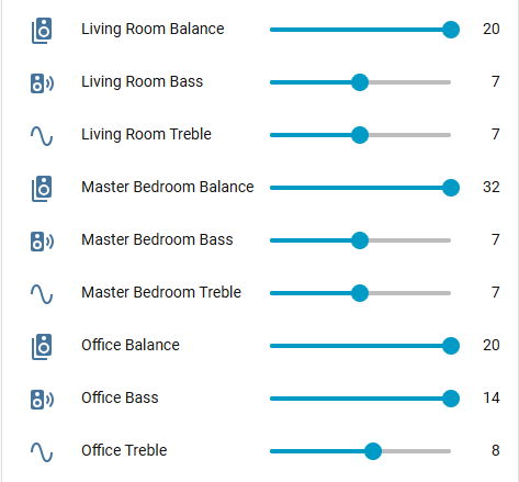

The balance, Bass and Treble controls now show up after I delete the old device and re-add it.
The Balance initializes with a value of 32. I can only adjust between 0 and 20. adjusting the balance does not make a difference. Adjusting the Bass and Treble works.

Thanks for the latest updates, balance, treble and bass all work great now.
