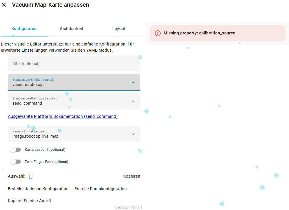

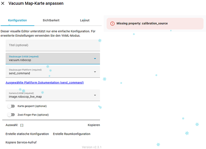

Hey, so I could re-integrate my vacuum in Home Assistant and am now again facing the calibration issue:
  1. Using the native robock integration
  2. Both of my map entities throw this error
  3. Using this (standard?) config of the card:
type: custom:xiaomi-vacuum-map-card
entity: vacuum.robocop
vacuum_platform: send_command
map_source:
  camera: image.robocop_live_map
Ah, got it:I had to add
calibration_source:
  identity: true
and now the map shows up.
But now, if I hit ā€œcreate room configā€ it throws an error ā€œUpdate of configuration failedā€ā€¦?

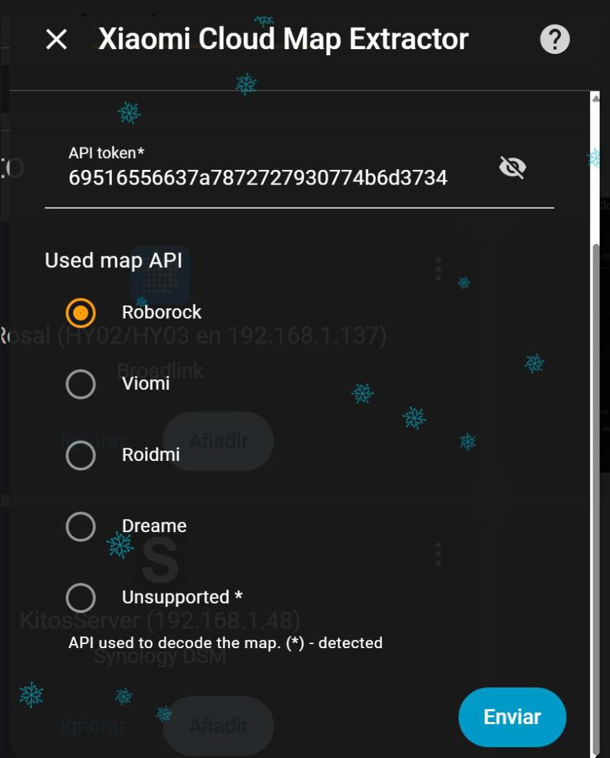

Hola, tengo una xiaomi vacum 5 pro y estoy intentando integrarla en HA. No consigo extraer el mapa con la nueva versión alpha de xiaomi extractor map, aunque puedo registrarme, superar el 2fa, etc… Cuando debo elegir el API map, me aparece no soportado y no funciona. Pueden ayudarme? Gracias de antemano.
@marcos210492-lab please use English here.
Try again with the latest alpha version of Map Extractor

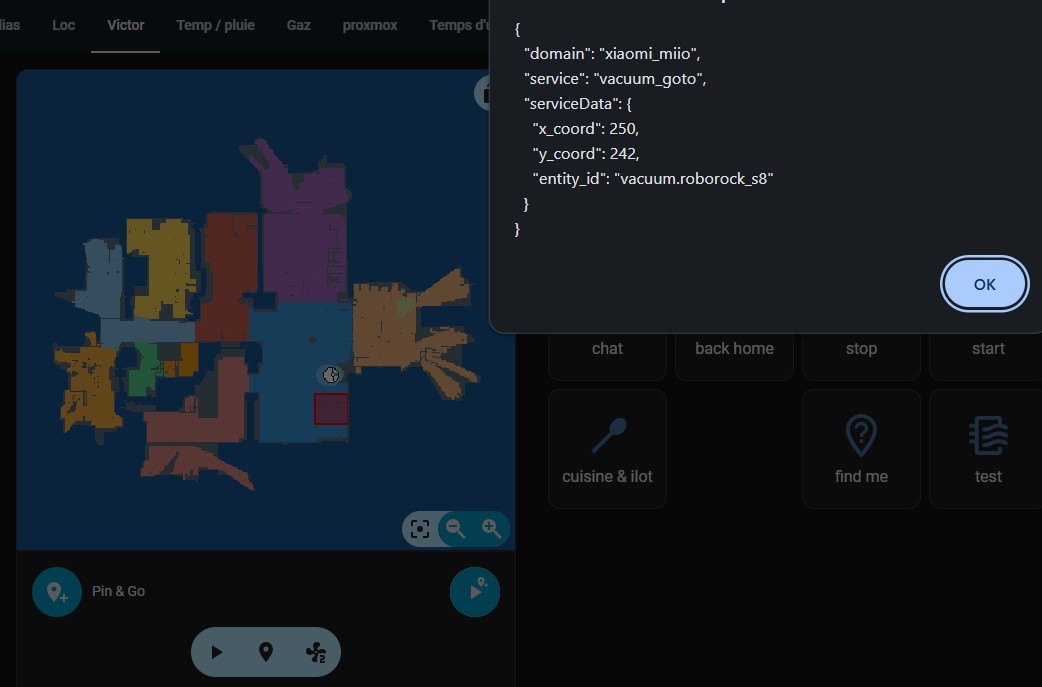

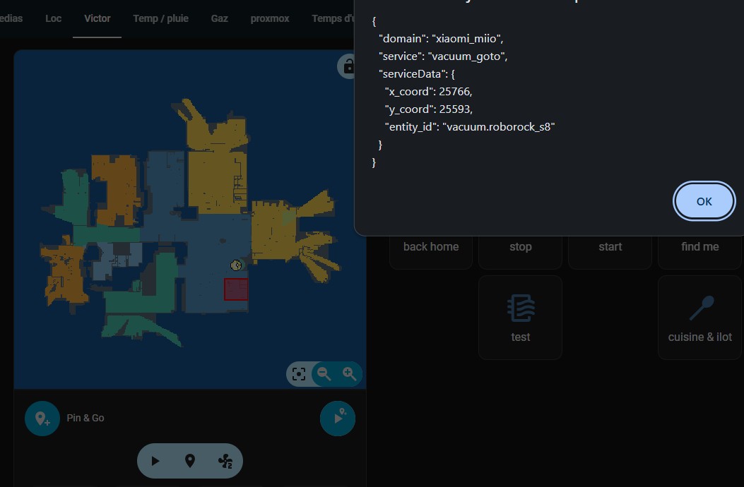

Hi Piotr, Thanks a lot for your great job and your personal investment for the community!
I’m currently using version 2.2.5 (last release) and investigating version 3 alpha 21 in a test occurence of HAOS.
I noticed a large difference regarding point coordinates on the map. Of course the 2 instances are connected in real time to the same vacuum Xiaomi S8.
As you can see on the 2 screen captures beside, the returned value are not at all in the same order of magnitude.
Any idea? I missed something?
Can you show configs of both cards?
I made a check of both map configuration (the yaml part) and I discovered at least one difference which has an impact on coordinates, the calibration source!
On the first it was camera: true on the second one it was identity: true
I don’t remember the reason of this change, a reasonning from the thread probably (Xiaomi Cloud Vacuum Map Extractor - #1183 by txomindeep):wink:
Where can I find some more explanation about the behaviour?
Both of them should use camera: true

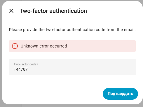

I’m trying to configure the Xiaomi Cloud Vacuum Map Extractor integration in Home Assistant, but I’m unable to complete the authentication process.
QR code authentication
When using QR-code login:
  1. The QR code is scanned successfully.
  2. Authorization is confirmed on the Xiaomi side.
  3. On the second step of the config flow, the integration fails with an error.
After this failure, any subsequent attempt to start the integration setup immediately results in an error, and the config flow cannot be loaded anymore until Home Assistant is restarted. After restarting HA, the same behavior repeats.
Username / password authentication
When using username and password:
  1. Credentials are accepted.
  2. Captcha is solved successfully.
  3. Xiaomi sends a verification code to my email (2FA).
  4. After entering the email verification code, the setup fails with an error.
If I start the setup again, I am prompted to enter the email verification code again, but submitting it always results in the same error.
Additional notes
  • The account has mandatory email-based 2FA enabled (no option to disable it in Xiaomi account security settings).
  • The error happens consistently and does not depend on the entered verification code.
  • The integration remains in a broken config_flow state after a failed attempt until Home Assistant is restarted.
Is this a known limitation related to Xiaomi’s email-based 2FA, or is there a workaround or fix available?
