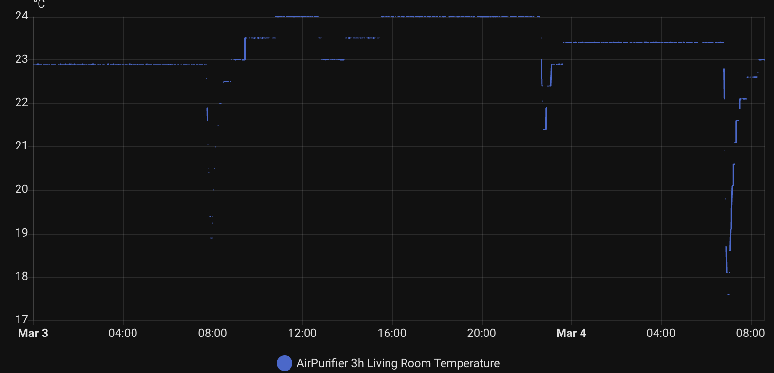

My Xiaomi Airpurifier 3H is frequently unavailable in HA with integration of Xiaomi Home, every minute or so. The device is powered, and it is on 2.4 GHz WiFi with a static IP.
Photo of a history graph in HA.
Did somebody have the same issue and have a solution?

i have had this also with my 3H device and finally switched to the esphome 3rd party firmware, since then, all is stable, so this is and issue with the firmware of the device and you can not do anything here i think.
The switch needs to demantle the device and this was hard, as its tight, the flashing was then easy.
So no really solution for you, but a way to go :slight_smile:

Is it possible that other wifi smarth home devices would be making some troubles?
Solved. Use the HACS integration GitHub - al-one/hass-xiaomi-miot: Automatic integrate all Xiaomi devices to HomeAssistant via miot-spec, support Wi-Fi, BLE, ZigBee devices. 小米米家智能家居设备接入Hass集成 · GitHub
How did you do? i am using this but pm2.5 update once every several hours
