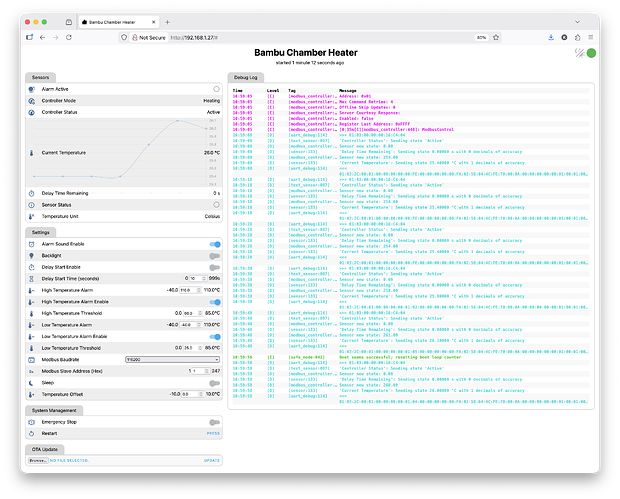

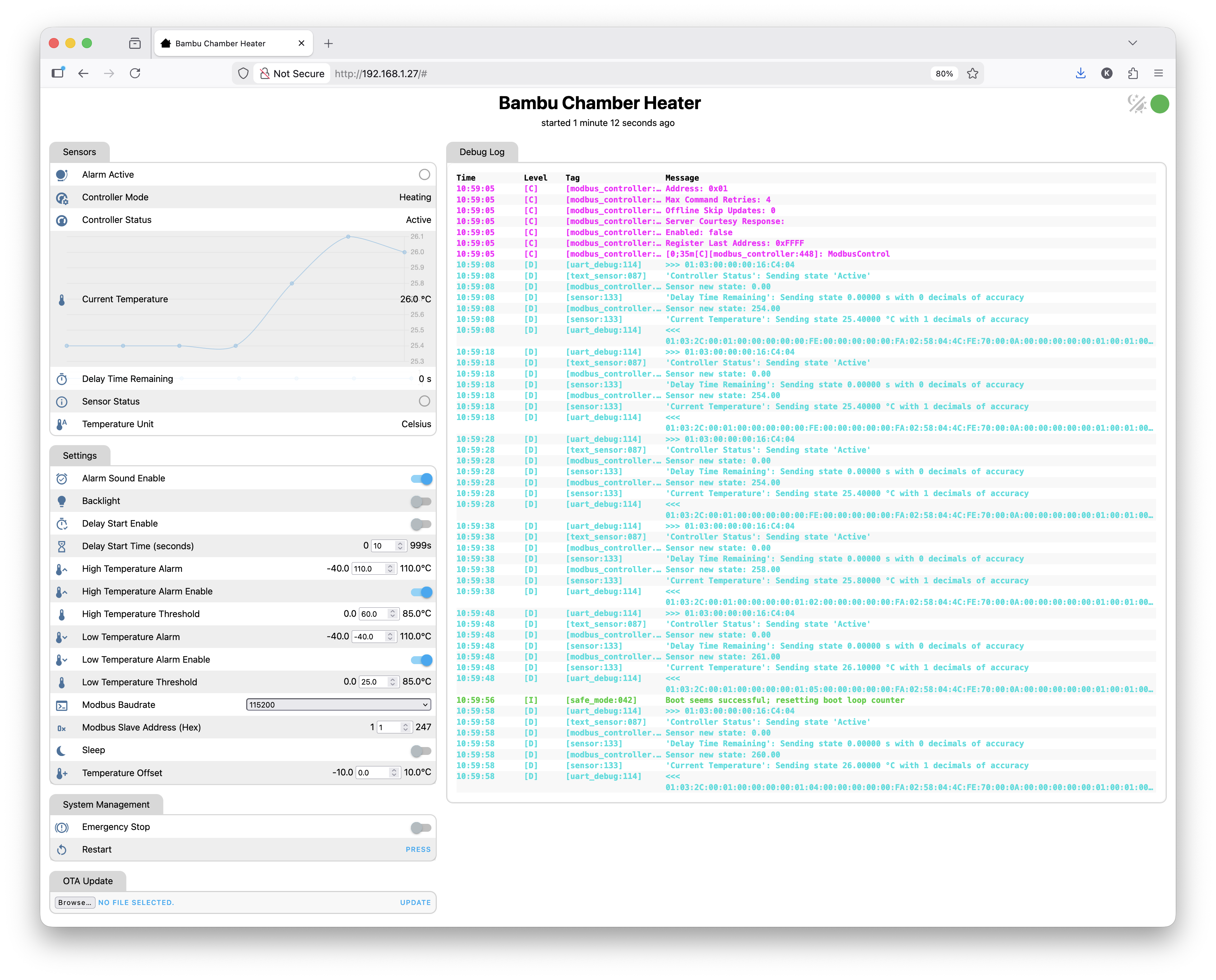

I did a major rewrite of this code (see screen capture for a preview), but I’m still struggling to decipher the last two Sinilink Modbus addresses: 0x0014 (sleep switch) and 0x0015 (backlight grade). Neither seems to be doing anything, but I think the backlight address should be working. Does anyone have any ideas?

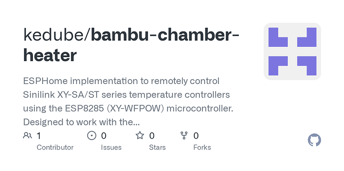

It’s still a work in progress, but I posted my work code to GitHub in case anyone is interested in testing it out or contributing. Thanks!
