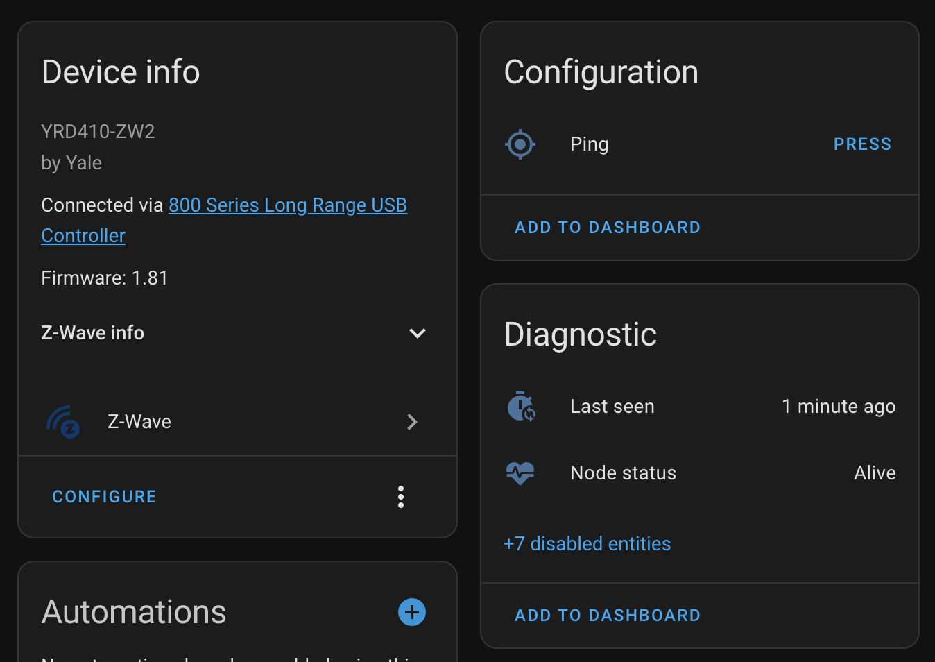

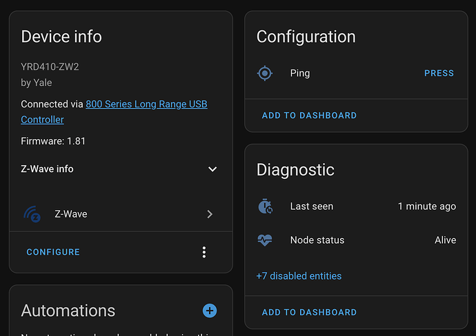

Yale Assure 2 - ZWAVE - No useful entities
Model: YRD410-ZW2
Zwave module Firmware: 1.81
It was detected by HA, but none of the useful entities is available, except last seen.
Any suggestions on how to fix? Re-Interview doesn’t change anything.

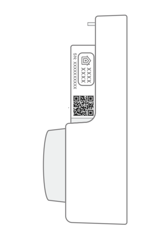

So, there are only 2 things in the lock itself (same as the manual):
  • A QR Code that’s for the Yale Access App (to configure the lock basics via bluetooth).
  • A homekit code.
    Like this:

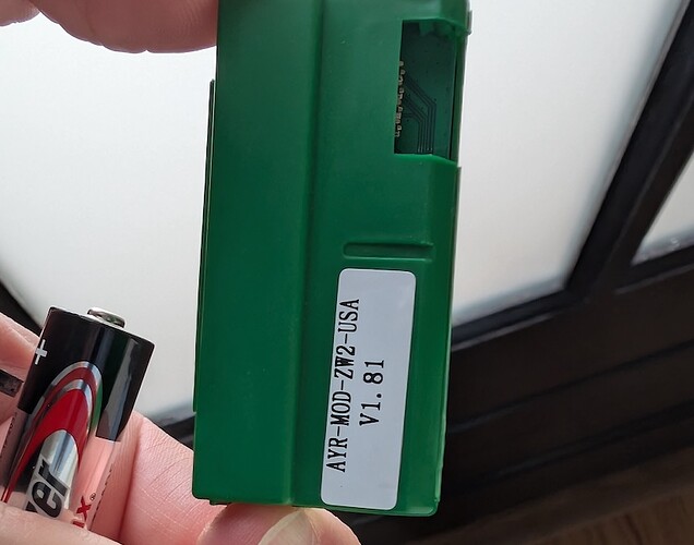

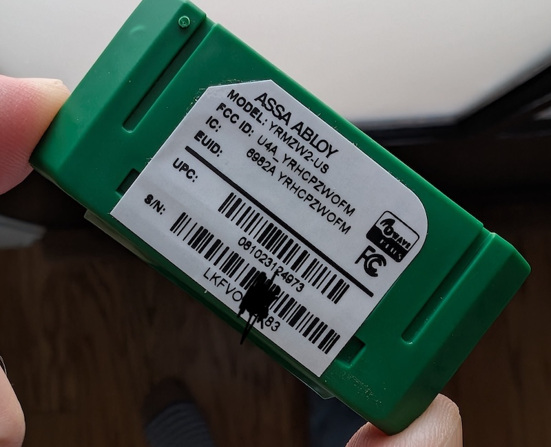

Then, on the module itself, there is only this information:
I will try calling Yale to understand if something is missing.
