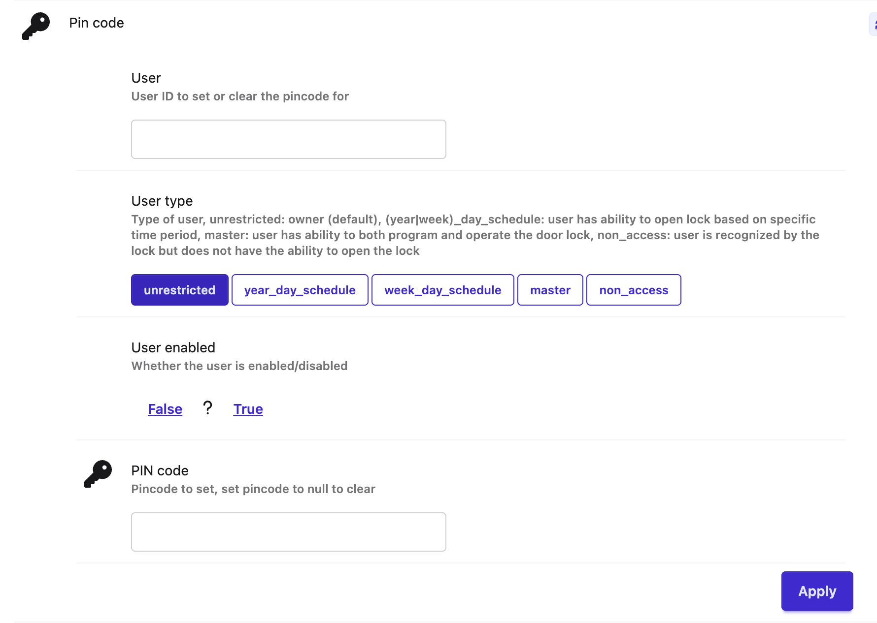

Hey @matt2468! Glad that you’re enjoying it. Scheduling is a little complicated. Some locks actually support that natively - so the Yale Assure locks let you specify some amounts of scheduling, see the attached image which comes from my Z2M dashboard for the device.

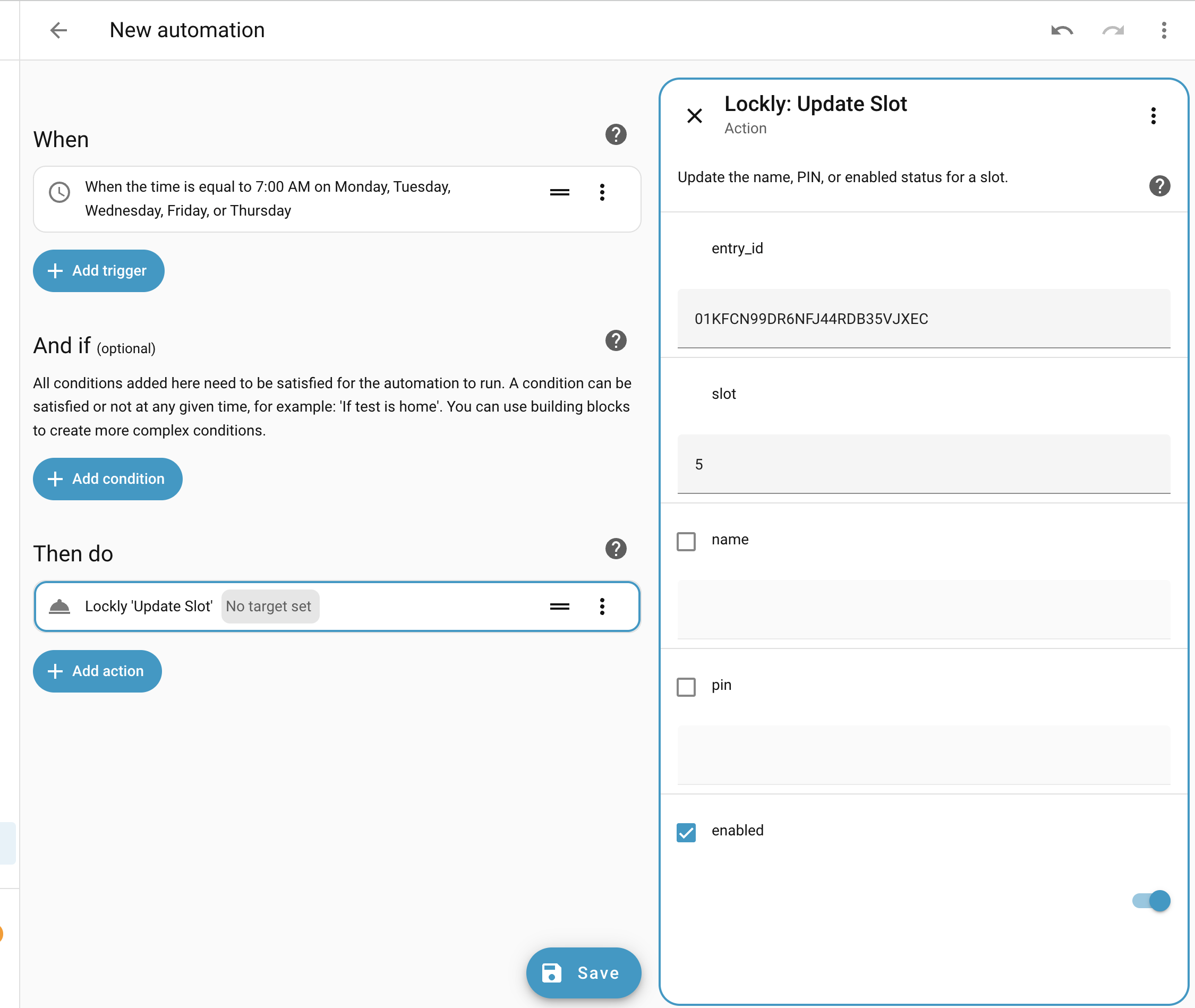

I did see these but its not quite clear how to use them to be honest :joy:
hey, no worries! I haven’t used them this way either. But I tried it out and I think you can create a new automation like this. See the screenshot. You need to get the right entry_id for the Lockly config (from Settings → Devices → Lockly → [gear icon for a specific entry]. Then you need to specify which slot you’re modifying. After that, you can modify the enabled status by checking its box (“I want to change the enabled status”) and then changing the slider to on/off (“I want this slot to be active or inactive”). Try it out!
Oh thats awesome! I didnt think to check using the lockly entities in an automation cheers!

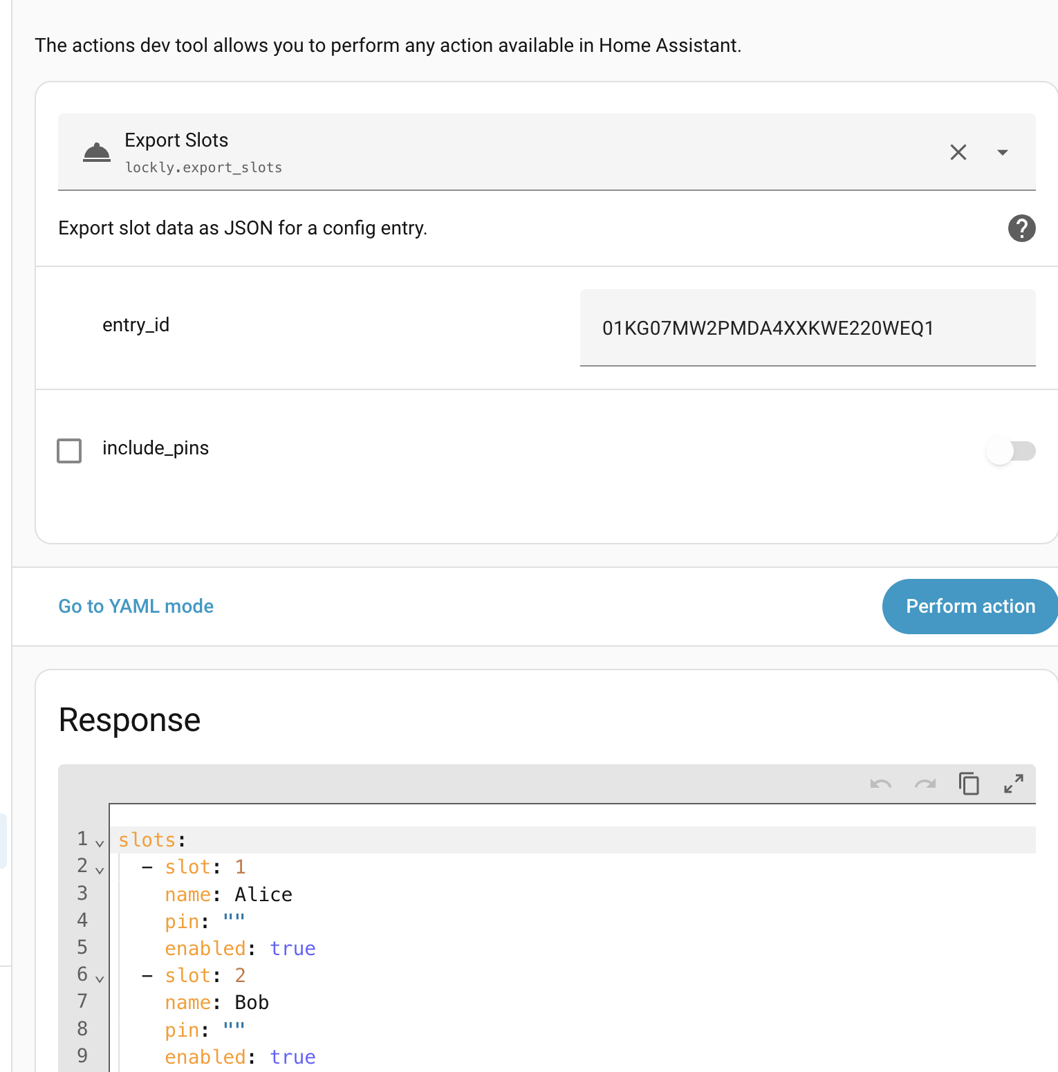

Hey @sytstex! Great idea. There is already a service called lockly.export_slots that exports all the slots

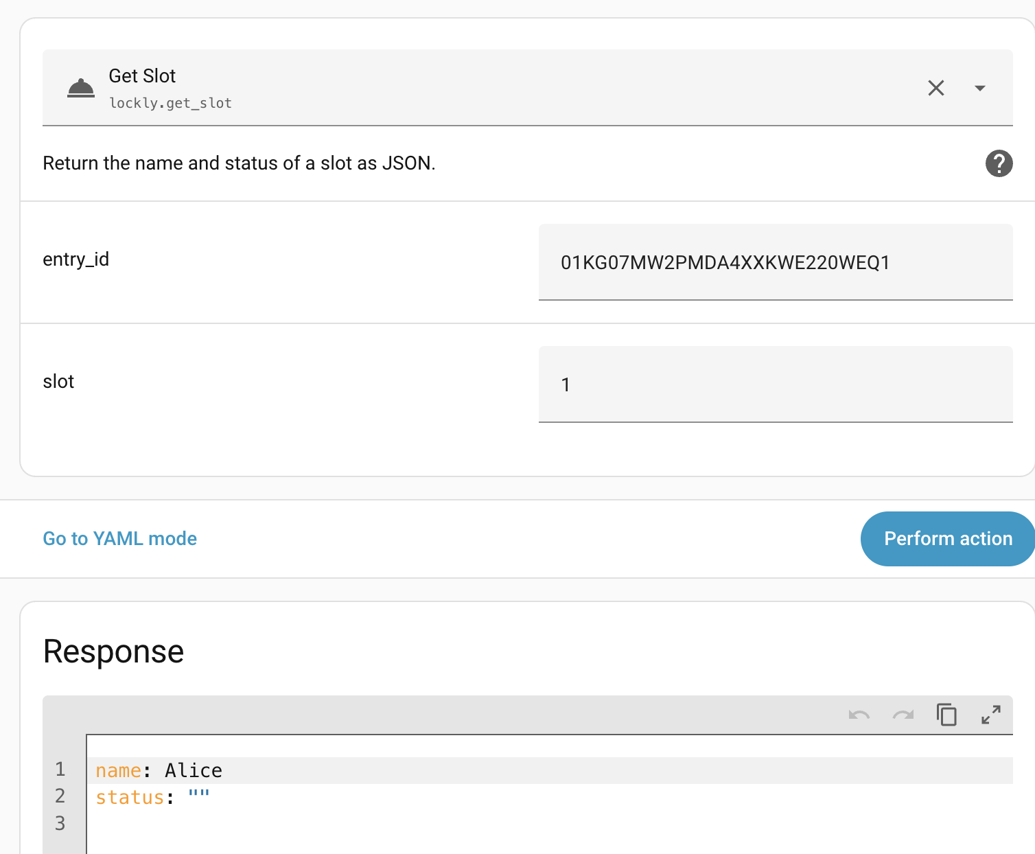

But I just pushed a change to add a service called lockly.get_slot which lets you get one slot.

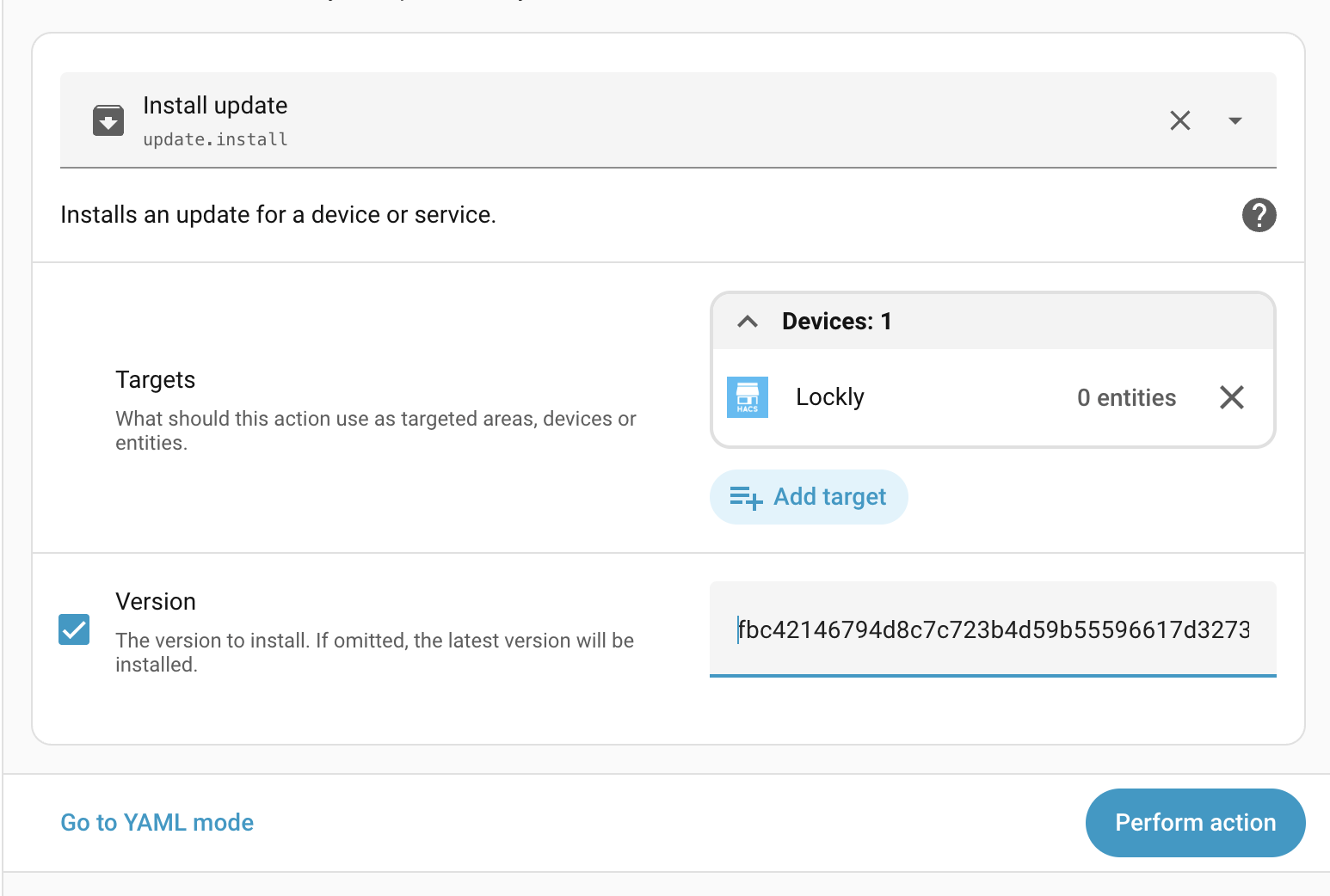

This is currently in github – I haven’t made a release, but you want to try it out you can install it by running this service:
Install version “fbc42146794d8c7c723b4d59b55596617d3273e4”

Thank you!

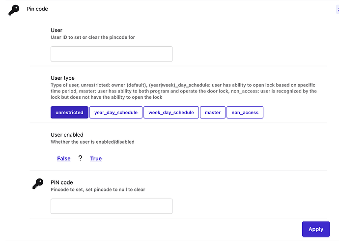

Seems like the service works great, but I’ve lost the “apply” buttons when clicking on a user entry in the dashboard card so I can’t actually enable/disable codes with this version. Not sure if I’m maybe doing something wrong on my end…
HA 2026.3 made some UI-breaking changes. I believe I fixed them in the latest HACS release of Lockly (1.0.3 IIRC). Can you check and let me know if it’s still not working?
All good with 1.0.3. Thank you!
