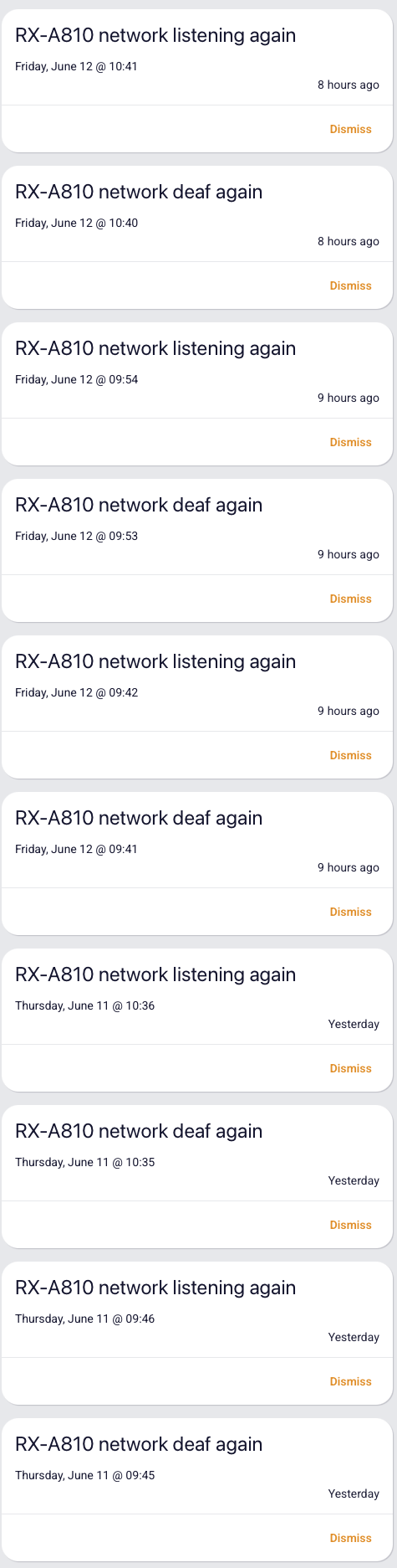

I now use an Automation to monitor the A810 and power it off then on again when it goes deaf and also send a notification.
Over the last 2 days it has gone network deaf 5 times and although today there were 3 instances but only 2 yesterday, there is something of a pattern there.
I can also say that previous days also showed just the 2 instances, but always at approx. those times.
Don't think this helps me to understand what on earth the Yamaha amp is doing, nor why, but it's interesting none the less.
