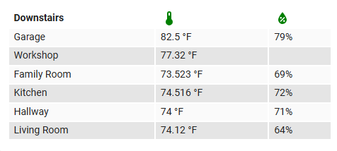

The data display like this (so far):
How do I suppress the display of or replace the text “undefinedundefined…”? Some of my sensors only have temperature, there is no humidity attribute.

All of my sensors support temperature, and only a handful don’t support humidity. As an example, here is what I ended up doing in my templates file:
sensor:
      - name: Tesla
        state: "Outside"
        attributes:
          temperature: '{{ states("sensor.red_rocket_inside_temperature_2")}} °F'
          humidity: >
            {% set hum = states('sensor.red_rocket_inside_humidity_2') %}
            {{ hum ~ '%' if hum not in ['unknown', 'unavailable', 'none'] else '' }}
This way, if a sensor has no humidity data, it will just show up blank in that column.

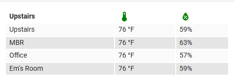

I also modified the card to use icons for the headings as shown here:
I created 3 separate cards for downstairs, upstairs and outside. I really like the ability to click on a heading to sort! Nicely done!

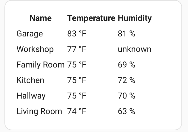

This should be all you need for the template in markdown card

<table>
<tr>
  <th>Name</th>
  <th>Temperature</th>
  <th>Humidity</th>
</tr>
{%- for item in data %}
<tr>
  <td>{{ item.name }}</td>
  <td>{{ states(item.temperature, True, True) }}</td>
  <td>{{ states(item.get('humidity', 'NA'), True, True) }}</td>
</tr>
{%- endfor %}
</table>

The ones I created using auto-entities and the templates look like this:
I didn’t do anything for formatting in the card itself, I think this is how the default works. I was able to figure out how to suppress “undefined” or “unknown” in the card using some formatting in the tempates.
It would be great to learn how to come up with something comparable using the markdown card. From there, I can experiment with different styles.
well, post what the markdown card produces and we can muck with it until it looks the same. It’s just HTML
OK, here is what the markdown card looks like in the dashboard:
