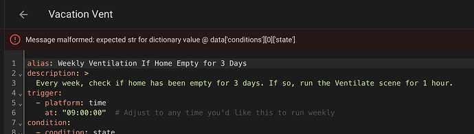

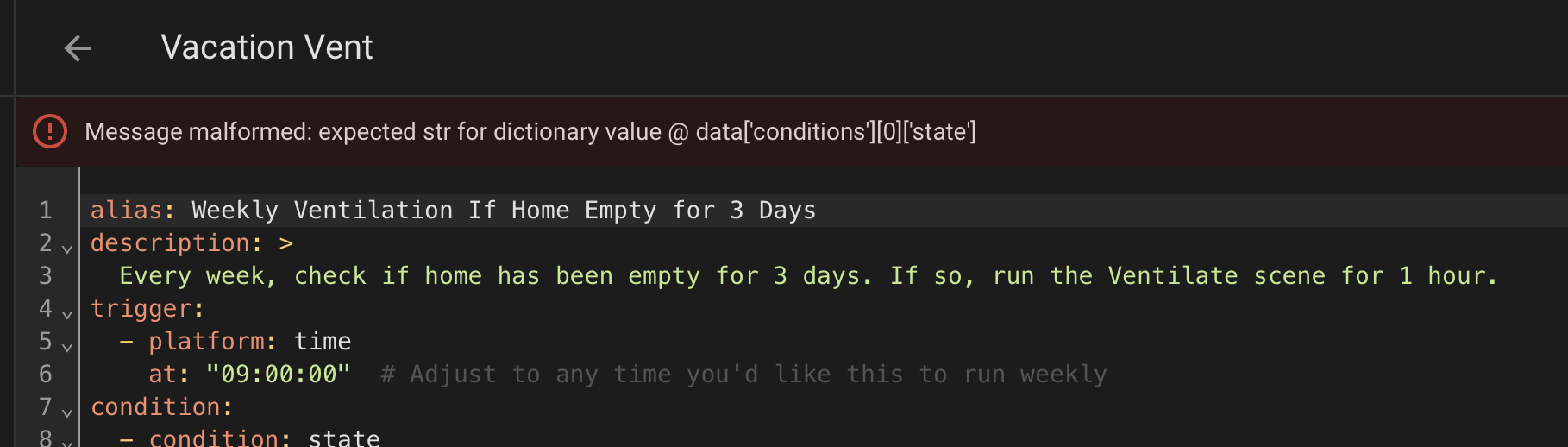

Admittedly that has also brought up an error on HA:
It looks like your yaml is a mix of old and new style format. You also used something meant for a trigger as a condition. Did you write this or did you use AI? My advice would be to build an automation in the automation editor and learn from it how to format the code before writing yaml by hand.
Half AI, half myself…
That’s because you removed the quotes completely instead of fixing them by replacing them with straight quotes. When configuring in YAML you need to make sure to use the expected data type… States are always strings, so you need to use quotes to identify that the zero is a string not an integer.
