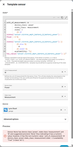

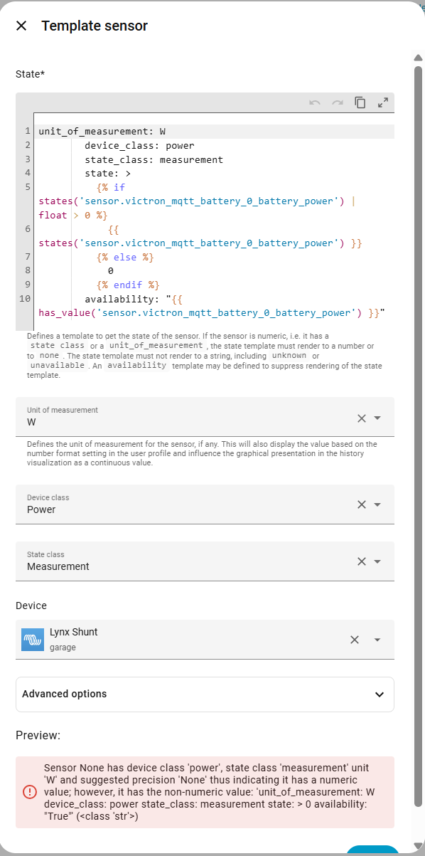

Hi Tom, when I filled in your YAML then I get this error message, can you help me with this?
I only have one sensor for charging and discharging the battery - sensor.victron_mqtt_battery_0_battery_power
BR,
Marcel
I provided the full YAML config with all the options for inclusion into configuration.yaml.
You have put all of that into just the state option using the GUI. The only bit that goes there is this, the part shown under the state: option in my config:
{% if states('sensor.victron_system_battery_power') | float > 0 %}
  {{ states('sensor.victron_system_battery_power') }}
{% else %}
  0
{% endif %}
