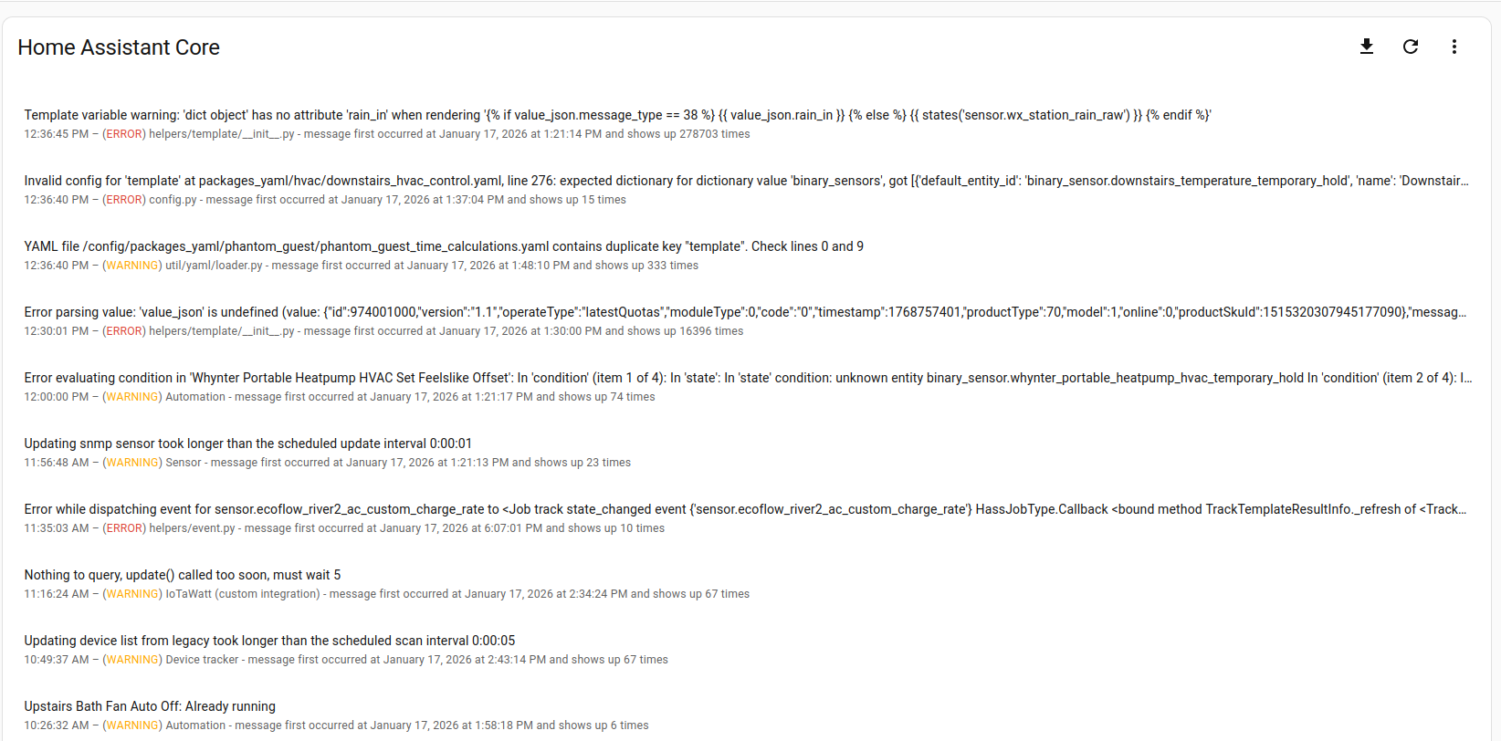

YAML not valid unless I duplicate 'template' key?
I’m refactoring my old template code to the new syntax, in the process I thought I would then combine duplicate template: blocks into one…but it then gives a TON of errors trying to reload.
Anyone able to tell why this might be?
Specifically I tried to remove the line:
template:
  - trigger:
to just
  - trigger:
which I assumed would go with the previous template block. But then I get LOADS of errors all over the place in the logfile.

As far as I could tell, removing the second template line should work. What are some of the errors you get?
Looks like you’re using packages, just noting it.
Ya that file should only have one (the first) template: in it, otherwise looks ok to me. What errors are you getting when you remove the second one?
Edit: Oops, a little slow here :wink:
@Edwin_D @HappyCadaver yes, I’m using packages, makes it easier for me to make my configuration grouped by capability and modular (duplicate, remove, share) without having it tangled with other capabilities.
They moved the logfile so its now hard to grep/filter, but when I remove the duplicate template line I get a TON of seemingly unrelated errors suddenly appear.
This isn’t the only file I have like this, I’ve got a few where I used trigger-templates that have the same strange issue.
Here’s the log commenting out the 2nd #template
line 159 errors here because of value_template isn’t an allowed option wthin a templae binary_sensor … it likely must read “state:” ?
And perhaps that lead to the point where it stumbles across the following duplicated “template:” ?
If these are template sensors that you manually migrated to the new format then it is a shame that you did not use the custom migration tool available or used the migrated yml provided by the repair that HA must have given. These contain vital bits that are required to make sure the new versions are an exact drop in replacement for the old one. Not using those mean you may risk that the entity id changes and automations break because of it.
OH! I thought I had caught all those…good eye!
That’s odd that everything seemed to be working perfectly without throwing errors when I had the second template key instead of throwing an error.
Maybe if the logfile had not been removed it’d be easier to filter for specific things among the million warnings that get printed as stuff initializes (because of course while they’re initializing many things will be unknown!)
Changing the value_template to state fixed my issue!
