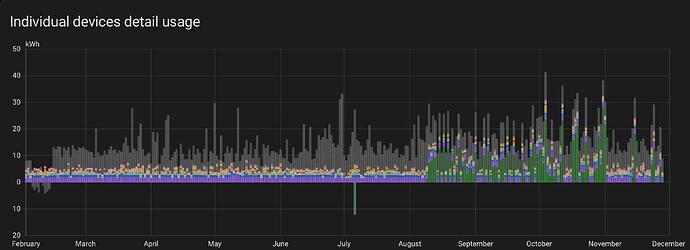

Year view energy dashboard seems to aggregate to beginning of year corruption?
I have been starting to use HA earlier this year.

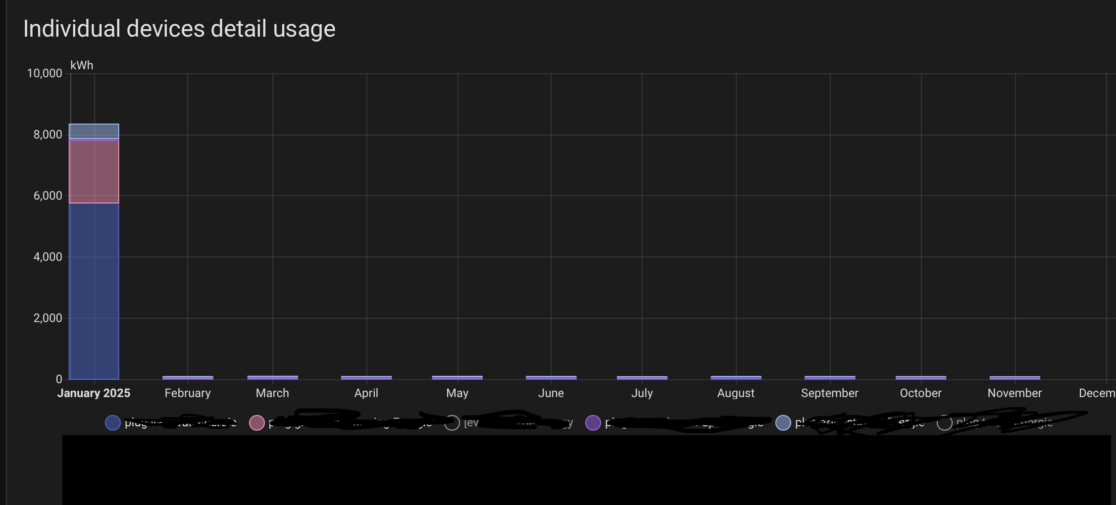

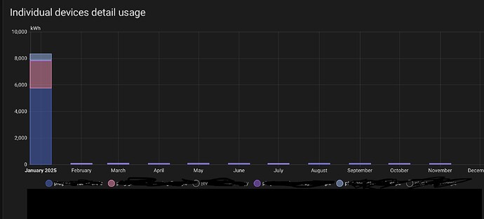

now reaching almost a year , I started to pay more attention to the year graph in the energy dashboard and somehow when I use the Year quick selector , it seems to aggregate a huge amount of energy in the first month.

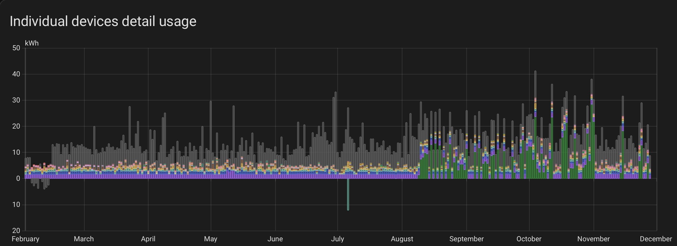

When I manually select the data ( and do not go past the initial early days of running HA ) it seems to have the correct data .

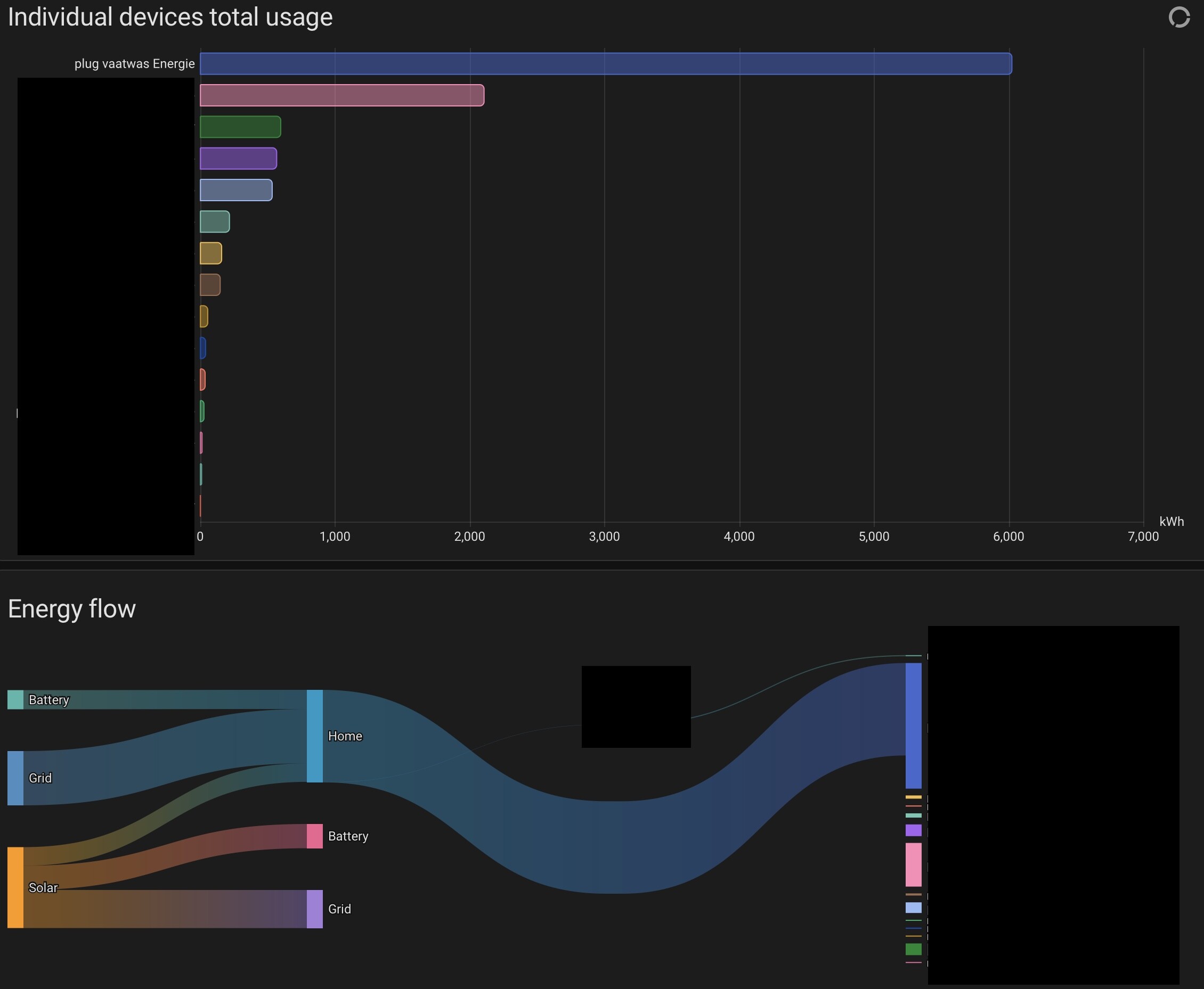

But its still quite annoying since it basically seems to claim that my dishwasher has consumed 6000 kwh
Are you asking if your early data is corrupt and you want to delete it from your database?
Dies this give you some clues?
There was an addon the other day that carefully documents the export/modify/import route you may also wish to follow.
