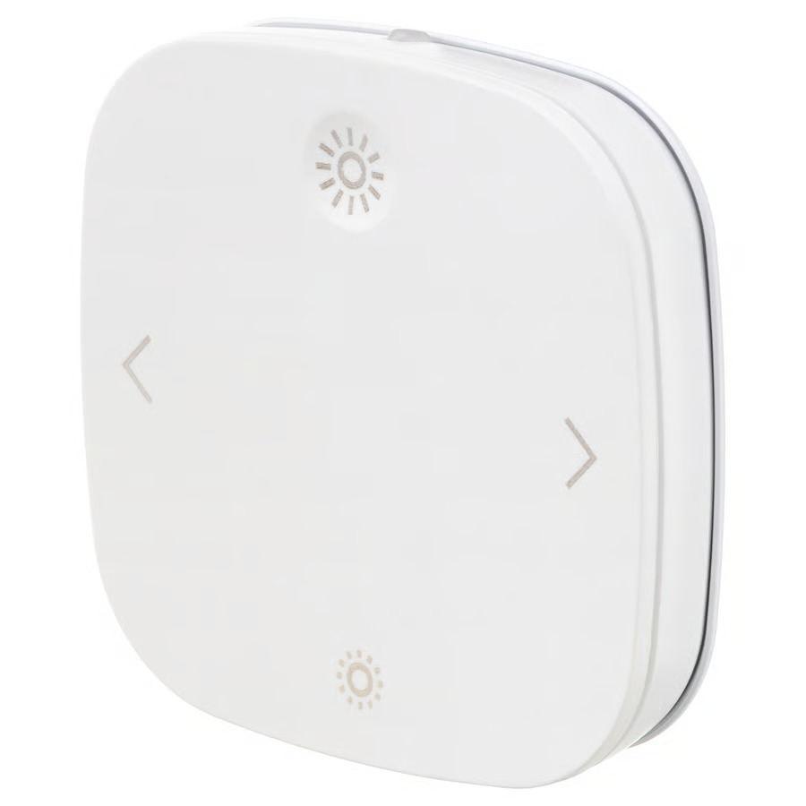

This blueprint allows you to control your lights with the Styrbar remote, offering basic functionality like turning lights on/off, dimming brightness continuously, and changing color temperature.
Features
  • Turn Lights On/Off – Use the center button to toggle lights on or off.
  • Adjust Brightness – Hold the top or bottom button to dim the lights up or down with smooth, continuous adjustments.
  • Safe Brightness Control – Brightness is clamped between configurable min/max percentages so you never end up with unusable values (like 0%).
  • Change Color Temperature Incrementally – Use the left/right buttons to adjust color temperature.
  • Safe Color Temperature Control – Color temperature changes are clamped between configurable min/max Kelvin values, with a configurable default fallback if the light is off.
  • Transition Time Option – Adjust the transition time for brightness changes.
  • Works with Zigbee2MQTT 2.0.0+ – Fully compatible with the latest version of Zigbee2MQTT, no need to enable the legacy action sensor.
  • Single Light or Group of Lights – Works with any light entity you select, whether it’s a single bulb or a group of lights.
