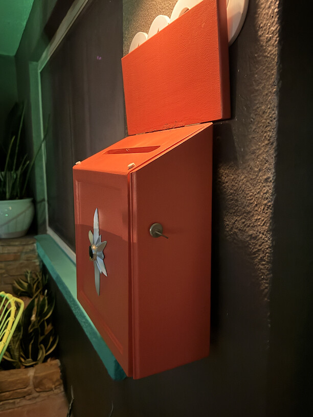

Good thoughts. Our mailbox is a wooden box with a slot on top, I think the design of it would protect the sensor from direct sunlight. Indirect sunlight may come from the top when the lid is open. Since the mail drops down in the box, I think putting the sensor towards the bottom would catch even small mail. I think im going to pull the trigger and give it a shot.

Deepsleep will improve battery life.wood is better than metal if decice is inside. How far from box to home? Show a pic of mailbox.
Mailbox is on the exterior of the house, range should not be an issue.

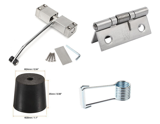

You have to go to the box to get the mail, you can close it...
The switch/lever/flap combo positioned inside the box triggered by mail being placed through the slot would work. Think like the garage door position switches (older units) for closed/open.

Yes on the roller switch, something to work on. Weight would be harder to determine (think postcard or ad flyers versus larger weight envelops/packages). So IR beam T/R might work in that box, I see it might be under a porch covering. You could put a solar charging for a battery device into the mix.
You could modify the box so lid tends to close if not supported by hand. Then you could use a 433mhz device with a reed switch. Cell in that would last > year unless you get 20 mailbox deliveries.
