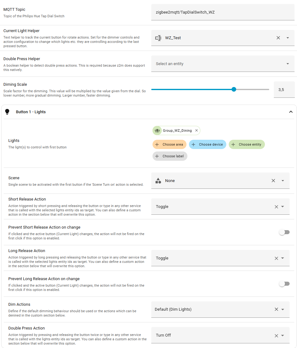

My config:

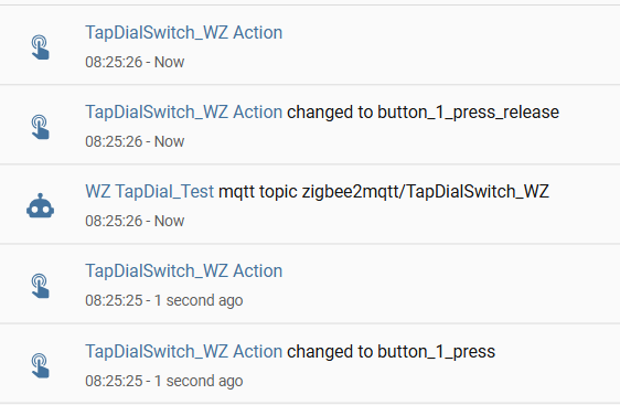

Activity Log:
That´s all that happens. The light in my group are not switched on or off.
Any hints? Thx…
Thanks for testing and sorry that it’s not working. I can reproduce this. Toggle seems not to be working at all and without the double press helper nothing happens too. I will try to fix it this weekend.

But it feels slow.
After pushing a button for about half a second nothing happens and then the light turns on.
The other blueprint I use is from AnderssonPeter. After pushing a button the light turns on immediately.
In your blueprint I like the option to perform an action on button push. On of my three buttons is used to start a script. Thats not possible on the other blueprint.
Maybe you can have a look on the delay.
Thx
This is caused by the Double Press check. I will add a feature soon to adjust the time out or disable it completly. Unfortunately it’s required because there is no native double press event in z2m for the dial tap switch.

@Hurst I updated the blueprint. You can now set the timeout yourself and if no helper is defined it’s 0 by default.
Thank you!
I had to set the Double Press Detection Timeout manually to 0, by default there was still the delay.
But with setting to 0 it works really good.

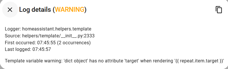

With last version one warning appears:

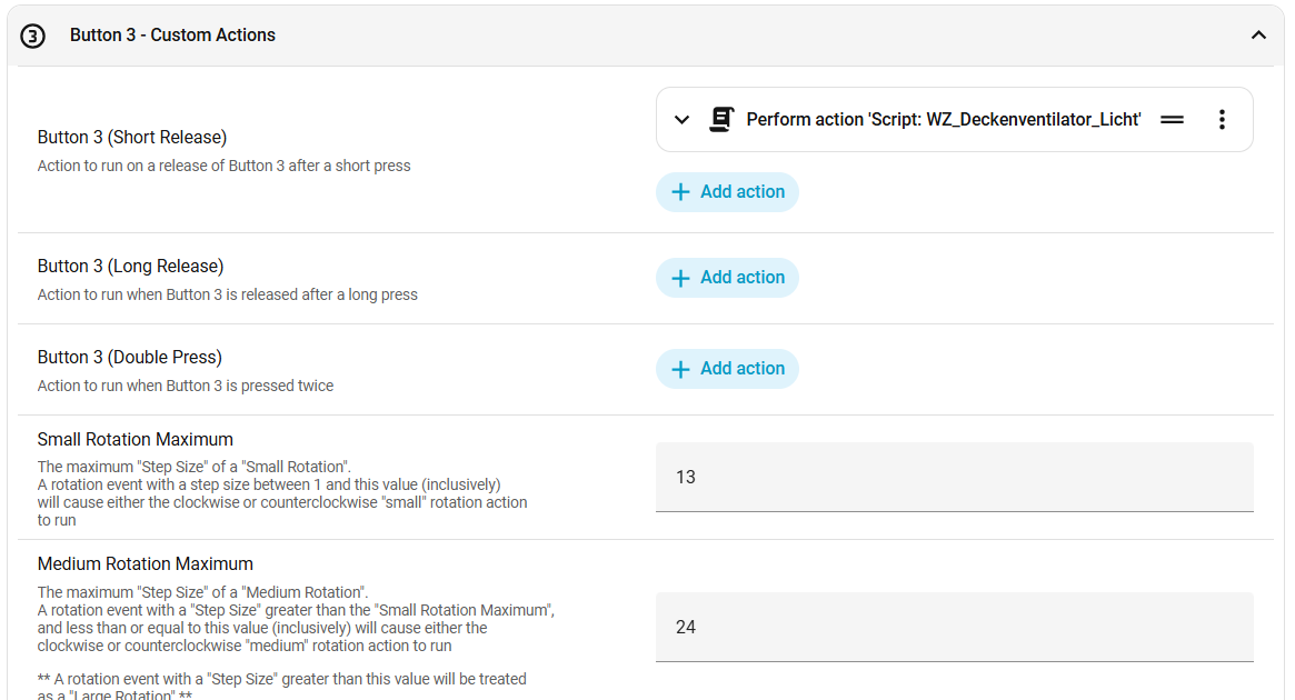

this happens when button 3 with a script is used:
And to clarify: Everything is working fine and as expected. It´s just the warning in the logs…
And I didn´t check the logs with the second to last version. So do not know, if the warnings do occur with this version.
Well, I added a few checks and currently I can’t see anymore warnings. I will observe it. If you still get warnings, please let me know,

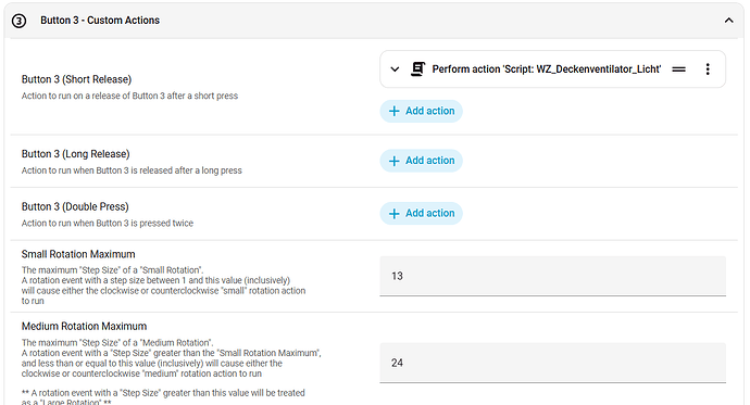

there is still this warning when button 3 (with script) is used:
Maybe you can have a look - but I think I can live with this warning :slight_smile:
I had to add a case differentiation in the loops with custom actions, but now it should be ok, if no target attribute exists, like in scripts.
Perfect - no warnings or errors in the log.
