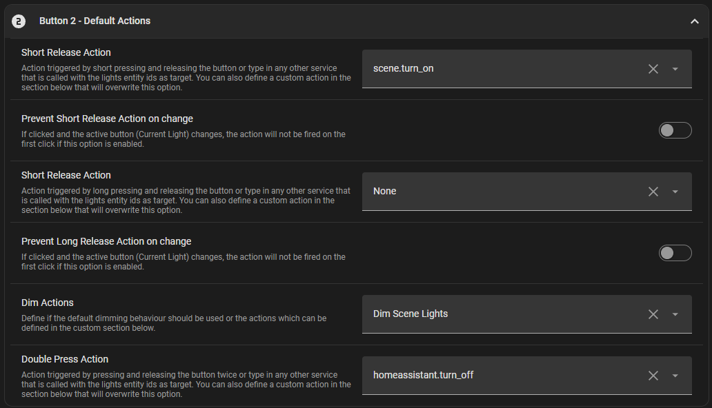

i installed the blueprint and configured it and some things came up:
  1. there is a typo, Buttom 2 has two times the Short Release Action and no Long Release Action
  1. When i use the four buttons to activate “normal” scenes i can use the Dim Scene Lights function. but that will dim all lamps inside the scene, even the ones i set to off in the scene. so when dimming upwards all lamps will begin to dim up.
  2. switchiing lights with “normal” scenes has the popcorn effect. therefore i switched to mqqt scenes inside the groups. but now i cannot dim the lights anymore.
i dont know if that is technically possible, but would be nice to use dim with mqqt and only dim turned on lights.
i am really new to HA and stuff, so be kind :wink:
great work so far, thank you!
