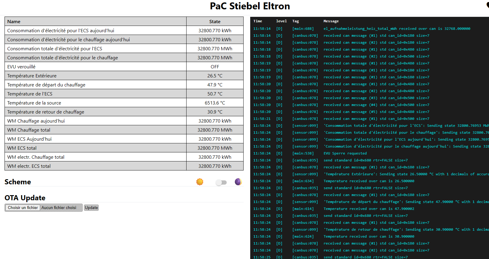

Yet another Stiebel Eltron Heating Pump newbee entusiast with a WPL 18 E and esphome
I am new in the wonderfull world of German heating pump.
As a former system engineer for Nixdorf/Siemens in the last century, I am able to understand some German technical words.
I just bought a house that had a heat pump installed in 2019.
this is a WPL 18 E
there is a WPM 2 (where I Connected X15 H and L to the mcp2515) (do I need a ground or + or - ? ) the ESP is running on a battery until the solution works.
there is a SBP200E and a SBB302WPL and outside there is the rest.
No schematic, no explanations, just “demerden sie sich”

[18:22:51][C][template.binary_sensor:028]: Template Binary Sensor 'EVU Lock'
[18:22:51][C][canbus:021]: config standard id=0x2a8

I even don’t know if my HW is running
and how to get the addresses of my config…
Up to now, I just powered down and up my Heating Pump after plugging the MCP2515.on the can-bus
help !!!
Well.after one week or testings, I could get something that seem to start working.
an esp32 and a MCP2515 spi canbus adapter.
while sniffing the bus I could get some addresses:
8      Received    19:36:37    98    Data frame    Standard frame    0x00000180    7             a0    79    0c    01    19    00    00
7      Received    19:36:37    81    Data frame    Standard frame    0x00000480    7             a0    00    5f    04    00    00    00
11     Received    19:36:40    92    Data frame    Standard frame    0x00000500    7             92    00    fa    01    99    00    43
104    Received    19:37:52    110   Data frame    Standard frame    0x00000601    7             66    01    fe    01    00    00    00
105    Received    19:37:52    126   Data frame    Standard frame    0x00000602    7             66    02    fe    01    00    00    00

as you can see, all about electricity consumption is completely wrong.
the outside temperature is one degree below the value writed on the WMW2 display, but seems fine,
only the source temperature is completely crasy.
by the way ECS stand for the french acronym “Eau Chaude Sanitaire” witch means domestic hot water or warm water in our case.
end of the post…
here is the log of my esp32:

[11:30:24][D][sensor:099]: 'Consommation totale d'électricité pour l'ECS': Sending state 32800.76953 MWh with 3 decimals of accuracy
[11:30:24][D][sensor:099]: 'Consommation totale d'électricité pour le chauffage': Sending state 32800.76953 MWh with 3 decimals of accuracy
[11:30:24][D][sensor:099]: 'Consommation d'électricité pour l'ECS aujourd'hui': Sending state 32800.76953 kWh with 3 decimals of accuracy
[11:30:24][D][sensor:099]: 'Consommation d'électricité pour le chauffage aujourd'hui': Sending state 32800.76953 kWh with 3 decimals of accuracy
[11:30:24][D][main:538]: EVU Sperre requested
[11:30:24][D][canbus:035]: send standard id=0x680 rtr=FALSE size=7
[11:30:24][W][component:278]: Component time took a long time for an operation (104 ms).
[11:30:24][W][component:279]: Components should block for at most 30 ms.
[11:30:24][D][canbus:078]: received can message (#1) std can_id=0x180 size=7
[11:30:24][D][sensor:099]: 'Température Extérieure': Sending state 26.50000 °C with 1 decimals of accuracy
[11:30:24][D][main:634]: Temperature received over can is 26.500000
[11:30:25][D][canbus:078]: received can message (#1) std can_id=0x180 size=7
[11:30:25][D][sensor:099]: 'Température de départ du chauffage': Sending state 51.40000 °C with 1 decimals of accuracy
[11:30:25][D][main:614]: Temperature received over can is 51.400002
[11:30:25][D][canbus:035]: send standard id=0x680 rtr=FALSE size=7
[11:30:25][D][sensor:099]: 'Température de retour de chauffage': Sending state 30.40000 °C with 1 decimals of accuracy
[11:30:25][D][main:624]: Temperature received over can is 30.400000
[11:30:25][D][canbus:078]: received can message (#2) std can_id=0x180 size=7
[11:30:25][D][sensor:099]: 'Température de l'ECS': Sending state 45.60000 °C with 1 decimals of accuracy
[11:30:25][D][main:594]: Temperature received over can is 45.600002
[11:30:25][D][sensor:099]: 'Température de la source': Sending state 6513.60010 °C with 1 decimals of accuracy
[11:30:25][D][main:604]: Temperature received over can is 6513.600098
[11:30:29][D][canbus:078]: received can message (#1) std can_id=0x480 size=7
[11:30:29][D][canbus:078]: received can message (#1) std can_id=0x500 size=7
[11:30:30][D][canbus:078]: received can message (#1) std can_id=0x480 size=7
xxx
[11:30:41][D][canbus:078]: received can message (#1) std can_id=0x500 size=7
[11:30:44][D][esp32.preferences:143]: Writing 28 items: 28 cached, 0 written, 0 failed
[11:30:44][W][component:278]: Component preferences took a long time for an operation (51 ms).
[11:30:44][W][component:279]: Components should block for at most 30 ms.
[11:30:45][D][canbus:078]: received can message (#1) std can_id=0x180 size=7
[11:30:45][D][canbus:078]: received can message (#2) std can_id=0x180 size=7
[11:30:49][D][canbus:078]: received can message (#1) std can_id=0x480 size=7
[11:30:49][D][canbus:078]: received can message (#2) std can_id=0x500 size=7
xxx
[11:30:59][D][canbus:078]: received can message (#1) std can_id=0x500 size=7
[11:31:00][D][canbus:035]: send standard id=0x680 rtr=FALSE size=7
[11:31:00][D][canbus:078]: received can message (#1) std can_id=0x480 size=7
[11:31:00][D][canbus:078]: received can message (#2) std can_id=0x180 size=7
[11:31:00][D][canbus:078]: received can message (#1) std can_id=0x180 size=7
[11:31:00][D][main:730]: waermemertrag_electr_ww_tag_wh_float received over can is 32.768002
[11:31:00][D][main:699]: waermemertrag_electr_ww_tag_kwh received over can is 32768.000000
[11:31:00][D][main:734]: waermemertrag_electr_heiz_tag_wh_float received over can is 32.768002
[11:31:00][D][main:703]: waermemertrag_electr_heiz_tag_kwh received over can is 32768.000000
[11:31:01][D][canbus:035]: send standard id=0x680 rtr=FALSE size=7
[11:31:01][D][canbus:078]: received can message (#1) std can_id=0x180 size=7
[11:31:01][D][main:738]: waermemertrag_ww_tag_wh_float received over can is 32.768002
[11:31:01][D][canbus:078]: received can message (#1) std can_id=0x480 size=7
[11:31:01][D][canbus:078]: received can message (#2) std can_id=0x480 size=7
[11:31:01][D][canbus:078]: received can message (#3) std can_id=0x500 size=7
[11:31:01][D][canbus:078]: received can message (#1) std can_id=0x500 size=7
[11:31:01][D][canbus:078]: received can message (#2) std can_id=0x180 size=7
[11:31:01][D][main:707]: waermemertrag_ww_tag_kwh received over can is 32768.000000
[11:31:01][D][main:742]: waermemertrag_ww_total_kWh_float received over can is 32.768002
[11:31:01][D][main:711]: waermemertrag_ww_total_mWh received over can is 32768.000000
[11:31:01][D][main:746]: waermemertrag_heiz_tag_wh_float received over can is 32.768002
[11:31:02][D][canbus:035]: send standard id=0x680 rtr=FALSE size=7
[11:31:02][D][canbus:078]: received can message (#1) std can_id=0x180 size=7
[11:31:02][D][main:715]: waermemertrag_heiz_tag_kwh received over can is 32768.000000
[11:31:02][D][main:750]: waermemertrag_heiz_total_kWh_float received over can is 32.768002
[11:31:02][D][main:719]: waermemertrag_heiz_total_kWh_float received over can is 32768.000000
[11:31:05][D][canbus:078]: received can message (#1) std can_id=0x180 size=7
xxx
[11:31:11][D][canbus:078]: received can message (#1) std can_id=0x500 size=7
[11:31:12][D][sensor:099]: 'WM electr. ECS total': Sending state 32800.76953 kWh with 3 decimals of accuracy
[11:31:12][D][sensor:099]: 'WM electr. Chauffage total': Sending state 32800.76953 kWh with 3 decimals of accuracy
[11:31:12][D][sensor:099]: 'WM ECS total': Sending state 32800.76953 MWh with 3 decimals of accuracy
[11:31:12][D][sensor:099]: 'WM Chauffage total': Sending state 32800.76953 MWh with 3 decimals of accuracy
[11:31:12][D][sensor:099]: 'WM Chauffage aujourd'hui': Sending state 32800.76953 kWh with 3 decimals of accuracy
[11:31:12][D][sensor:099]: 'WM ECS Aujourd'hui': Sending state 32800.76953 kWh with 3 decimals of accuracy
[11:31:12][D][canbus:035]: send standard id=0x680 rtr=FALSE size=7
[11:31:12][W][component:278]: Component time took a long time for an operation (91 ms).
[11:31:12][W][component:279]: Components should block for at most 30 ms.
[11:31:12][D][canbus:078]: received can message (#1) std can_id=0x180 size=7
[11:31:12][D][main:645]: el_aufnahmeleistung_ww_tag_kwh received over can is 32.768002
[11:31:12][D][main:676]: el_aufnahmeleistung_ww_tag_kwh received over can is 32768.000000
[11:31:13][D][canbus:035]: send standard id=0x680 rtr=FALSE size=7
[11:31:13][D][canbus:078]: received can message (#1) std can_id=0x180 size=7
[11:31:13][D][main:653]: el_aufnahmeleistung_ww_total_kkWh received over can is 32.768002
[11:31:13][D][main:684]: el_aufnahmeleistung_ww_total_mWh received over can is 32768.000000
[11:31:13][D][main:649]: el_aufnahmeleistung_heiz_tag_wh received over can is 32.768002
[11:31:13][D][main:680]: el_aufnahmeleistung_heiz_tag_kwh received over can is 32768.000000
[11:31:13][D][main:657]: el_aufnahmeleistung_heiz_total_kWh received over can is 32.768002
[11:31:14][D][canbus:035]: send standard id=0x680 rtr=FALSE size=7
[11:31:14][D][canbus:078]: received can message (#1) std can_id=0x180 size=7
[11:31:14][D][main:688]: el_aufnahmeleistung_heiz_total_mWh received over can is 32768.000000
If you have any idea about my errors, please tell me I would be glad to listen to you !!!
Nobody can tell me what means
d2 00 fa 01 d4 fe 70  means ?
it should be the answer to my #Quellen-Temperaturabfrage except than the answer is 6513.6 °C and I guess that it is wrong, or my heatpump has already melted… ???
